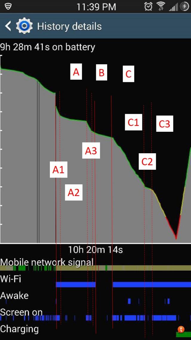

Pretty much everything looks good but the screen. Here is the picture below. I made the screen brightness half and auto and also auto turn off at 15s

When you get to that screen, click on the graph at top. It will expand that graph and more importantly, it will replace the list of programs below with indicators for wifi on, screen on, awake, etc. Again lots of device awake time when screen is off would be a problem.

I don't think it's a wakelock problem since the heavy usage only occurs within screen on.
I've marked up with some lines.
Wifi on in period A, off in period B, on in period C. These three separated by solid lines.
Within these I break it up into subregions A1,A2 etc separated by dashed lines.
Within period A, very heavy drop in time A1 when screen is also on. Could perhaps be some data transfer that occurs on wifi only. Period A2 has screen off and low usage. Period A3 again screen on and heavy drop.
Period B screen off (and wifi off), low drop.
Period C1, screen on (and wifi on), heavy drop. Period C2, screen off, low drop. Period C3 screen back on, heavy drop.
So, the big factor from above seems to be screen. Which we might think ould be screen power or other things that take power when screen on. But from previous screen you used 69% of power with screen which which suggests the screen itself is the big factor and other items are lesser. You mentioned you "lowered" your screen. Is it on auto? Auto gives me by far the best battery life although I use my phone mostly indoors. Also think about setting your screen timeout to 1 minute or less.

I don't disagree, but the built-in battery stats app doesn't show partial wakelocks. So, it could still be an issue. I like the divide & conquer approach for problems like this. Try Wakelock Detector first to either rule it out or in. If it gets ruled out, then you know what it's not. At that point, move on to GSAM or Better Battery Stats and follow where that leads you.
I was typing my response and didn't see yours. Not trying to argue with you, just giving my opinion. Since the huge battery losses occur when screen on, I personally wouldn't waste my time hunting down wakelocks (Better Battery Stats is not an easy program to use/interpret without some study). On the other hand, if it loses a lot when sitting idle overnight, that's what I'd look for wakelock problems.
I agree with you the quick drop in period A1 may have been data transfer that was "waiting" for wifi to be turned on (some data transfer doesn't occur unless wifi is on, depending on settings).
