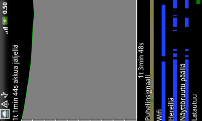

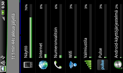

Attached are the two views where the remaining time "akkua j

I think the number at the bottom of the first screenshot is the length of time the phone has had a signal. See if it increases the longer the phone is off charge? I'll do the same with mine.
I think it must be a translation error. :confused:
Scrap the above actually, I've no idea what that number is. I did some basic sums and what I suggested doesn't add up.

Here's mine for a translation:
When you go to Settings >> About Phone >> Battery Use, click on the graph at the top and it should open the second screen.
Presumably, the text under the graph indicates the length of time the graph depicts. However, if you look at mine, I don't see why the phone has been off charge for almost two hours, yet the graph depicts only an hour and a half.
A complete random guess is that the graph isn't used when the phone is at 100% charge, so it took my phone 25 minutes (of no use) to dip to 99%.
This cleared the issue. It's a translation error. The Finnish translator had to choose between 'battery use so far' and 'battery remaining' when translating, and chose the wrong one.
