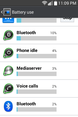

Notice Bluetooth listed twice on the Android 4.4 (KitKat) Settings/Battery/drain report.
That day I was using Bluetooth and had it ON (reason for the 2nd Bluetooth listing).
