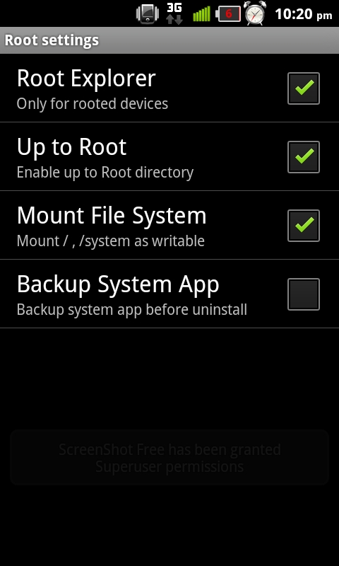

Okay, first you need to press your menu key and go to settings. Next, in the first attachment you can see Root settings. Tap on that to get to the menu in the second attachment. Make sure the boxes are checked as I show in the picture. Then go back and try to delete the file.
Unable to get to this screen in recovery. Could you provide step by step instructions? sorry but this is brand new to me.
I don't understand , "r/W", this is my first time rooting a phone and my first attempt using a different ROM. Thank you for the quick reply.
R/W means "read and write," meaning the /system partition (and therefore folder) can be written to and read from. Otherwise any attempts to write to that part of the device will most likely result in an error. And sure, no problem! That's what we're here for. :)
