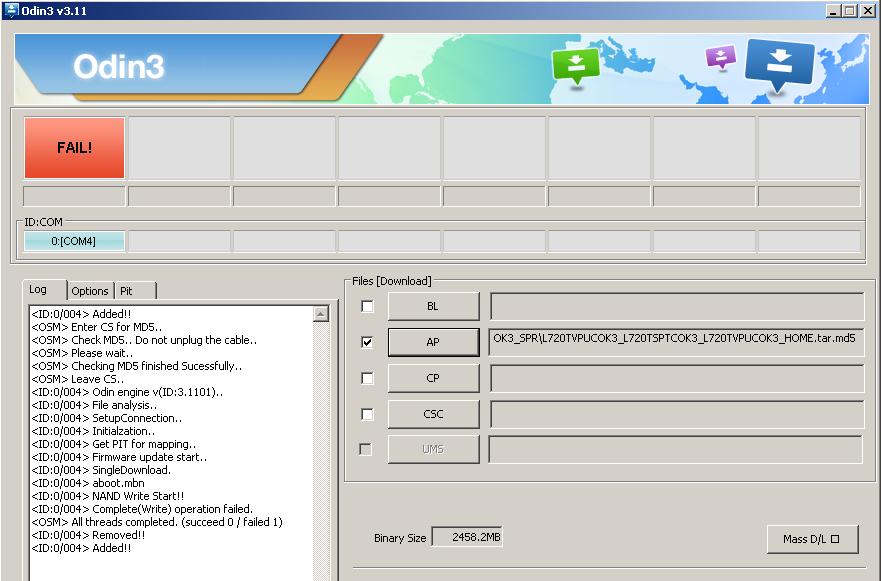

Well, I went and did it, going by the sammobile link you gave above, did everything exact, but Odin keeps giving an error. Now I have no recovery at all. I can only get into Download mode and thats it.
Screenshot below.
i tried to backtrack, reinstall twrp like in the first post, but that didnt work either, same error, seems to have something to do with the NAND being locked i guess? wont write to it?
I'm lost.
I should have left it alone lol
shit.
It should have worked. Looking back through the thread, OK3 was the Android version that you were on so your not trying to downgrade. Was there any message on the phone?
Have you tried to flash again?
There is a NAND erase all option, what about that (in odin)
? ... or will that not matter ?

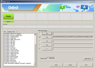

I figured it out. I fixed it. It works fine, I think ... lol
I'm about to find out. All is done, phone is off and charging, all I have to do right now is turn it on and go through the first-time user setups and all of that. I'm confident there are no problems. I should have known better, it was my own fault this happened due to me being lazy 6 months ago.
This is what I did wrong:
I am still on an old XPpro machine, 6 months ago I reinstalled Windows, but put off installing
the jdk-7u21-windows-i586.exe file I use, as well as steering my system path to where my Android
SDK Tools folder was.
I checked to make sure the drivers were installed, they were, I didnt forget that 6 months back.
So realizing this, I updated the path, ;D:\Development\Android\sdk\platform-tools
and then installed the Java JDK, rebooted, then started it all over again.
That fixed it and it it all went fine.
Dumb-Me.
Thankyou for your help man!
I'm going to start it up now, I'll report back.

It's all good.
It booted up fine and then it updated the system with the new ota update.
Not really anything new you can see, but the software, baseband, kernel and build numbers have changed.
SOFTWARE version: L720TVPSCPL1
BASEBAND version: L720TVPSCPL1
KERNEL version: 3.4.0-4745659 12/20/2016
BUILD number: LRX22C.L720TVPSCPL1
I just wanted to have it up to date.
