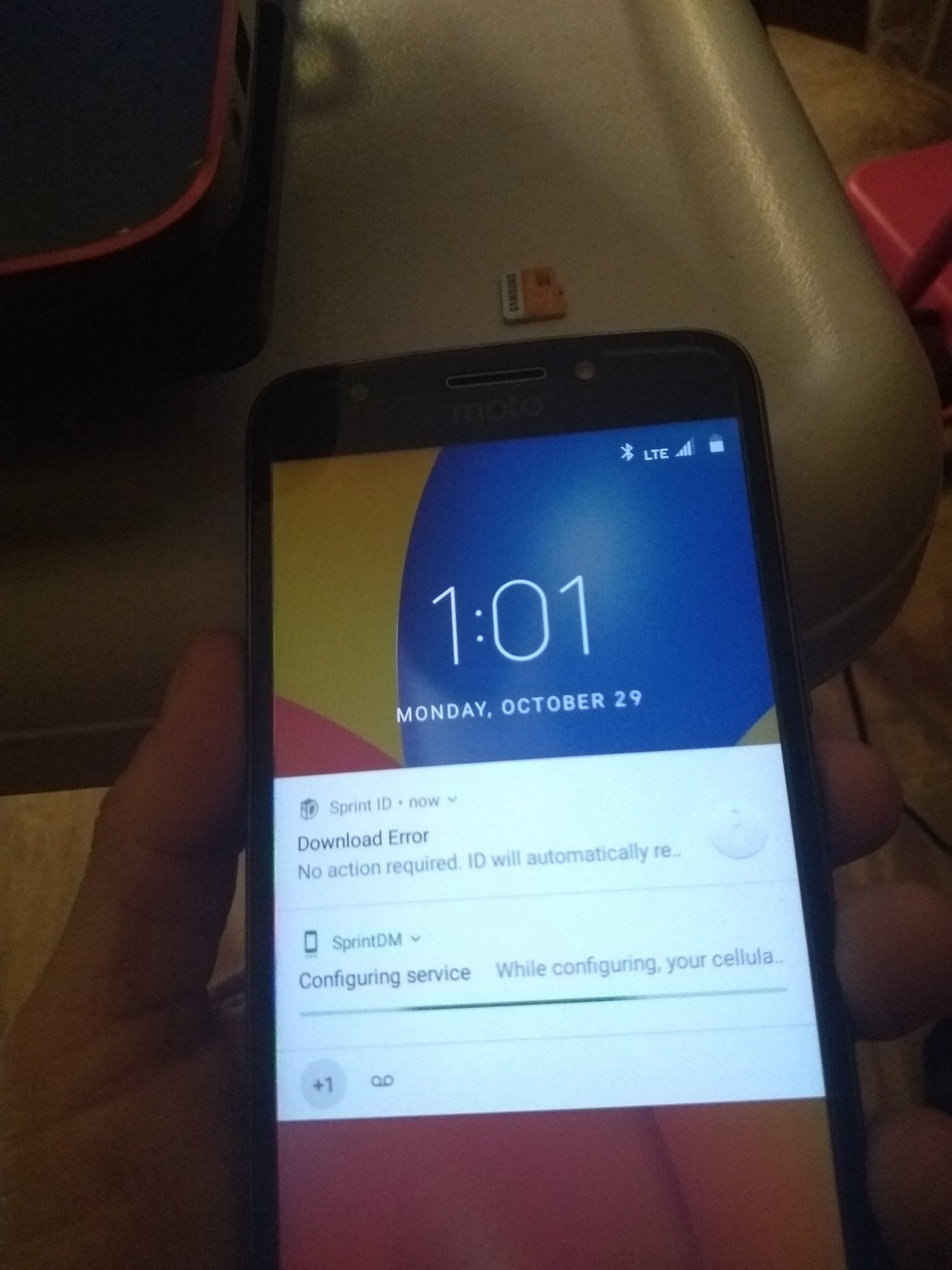

Yo. It's done. Total unbrick. All thanks to our ole buddies I mentioned earlier helping out. I'm gonna get with him about posting the owens Unbrick thread. He may just have me do it, I'll find out and see y'all get some help with this real soon
