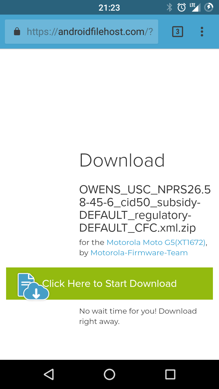

It has helped me out and not I can receive updated, but for whatever reason I cannot lock my bootloader as fastboot says that the boot.img is not signed, or some silly error.
thanks bchrister for all your help. Anyway, this is weird.
Apparently, the twitter account Motofirmware123 posted a new firmware for owens, but it is not listed on their list for e4 plus. I found it by reading their twitter posts on their July 21st, post.
https://twitter.com/MotoFirmware123
<span style='font-size:15px';>OWENS_USC_NPRS26.58-45-6_cid50_subsidy-DEFAULT_regulatory-DEFAULT_CFC.xml.zip</span>
but here it is:
https://androidfilehost.com/?fid=5862345805528054969
There's a serious error here.. All our updates were in NCRS26.58-44 to NCRS26.58-44-12 series, no 45's involved I could find. Also, Owens is supposed to be a Moto E4 Plus.. Not a G5 ;)

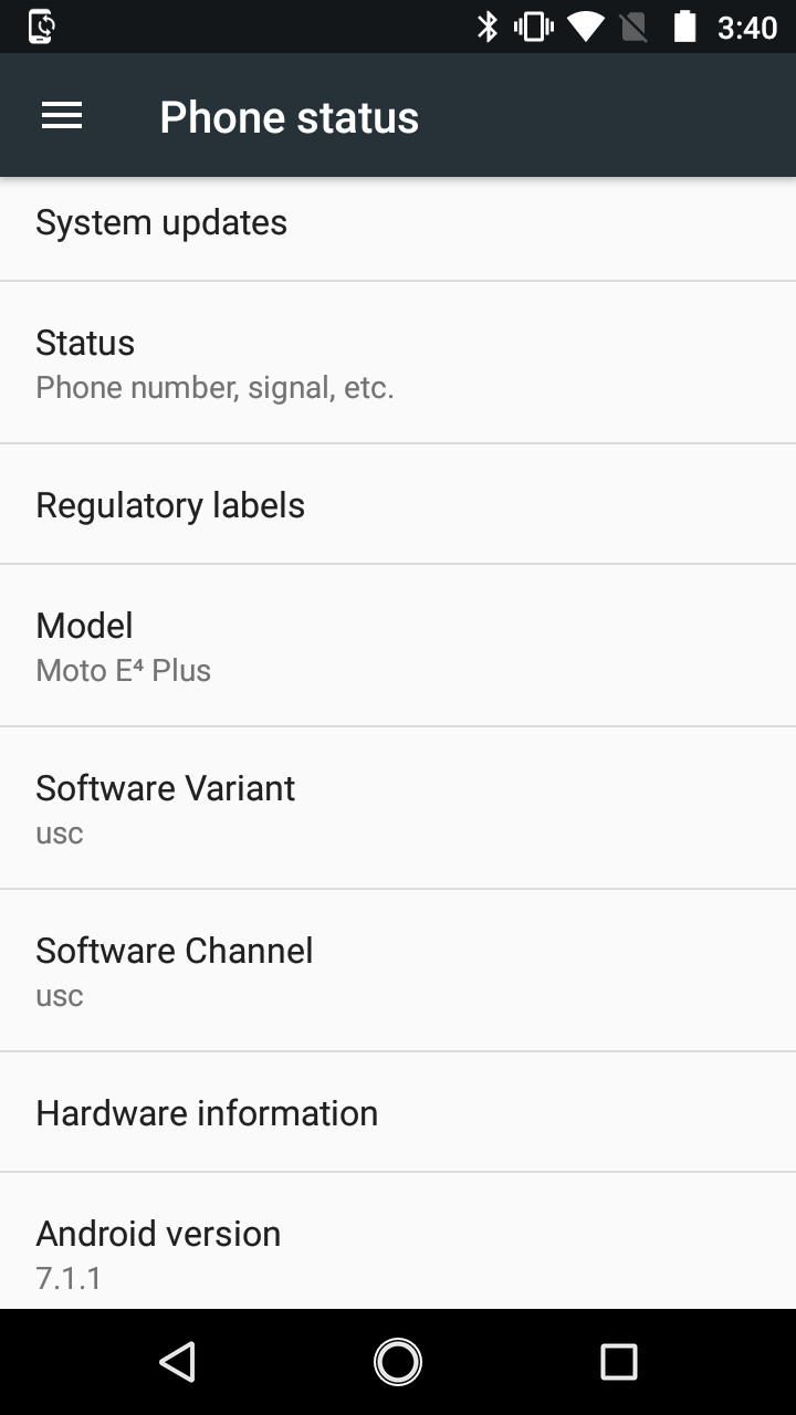

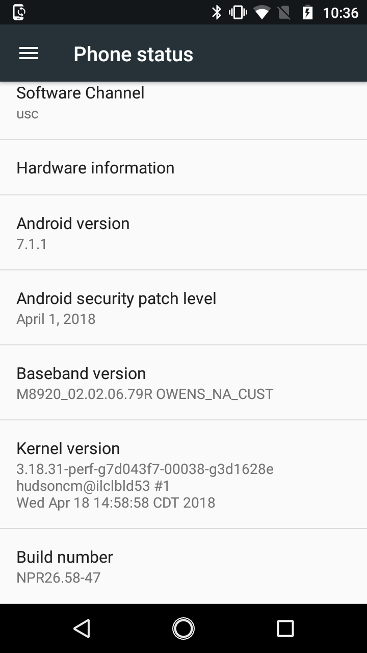

weird, but my owens e4plus from us cellular ate this stock rom like it was butter. only failure was the signed image problem. Then phone then managed to get the next sytstem phone updated to the next security level. (I have the blur-zip update if that helps anybody)
Thank you for pointing this FW out, if we can get all the appropriate verification with your assistance, the info can be added to the OP. Which update are you running, can ya send some screenshots (pwr + vol down) of the "about phone" section? I'd like to check it out.. Thanks in advance
