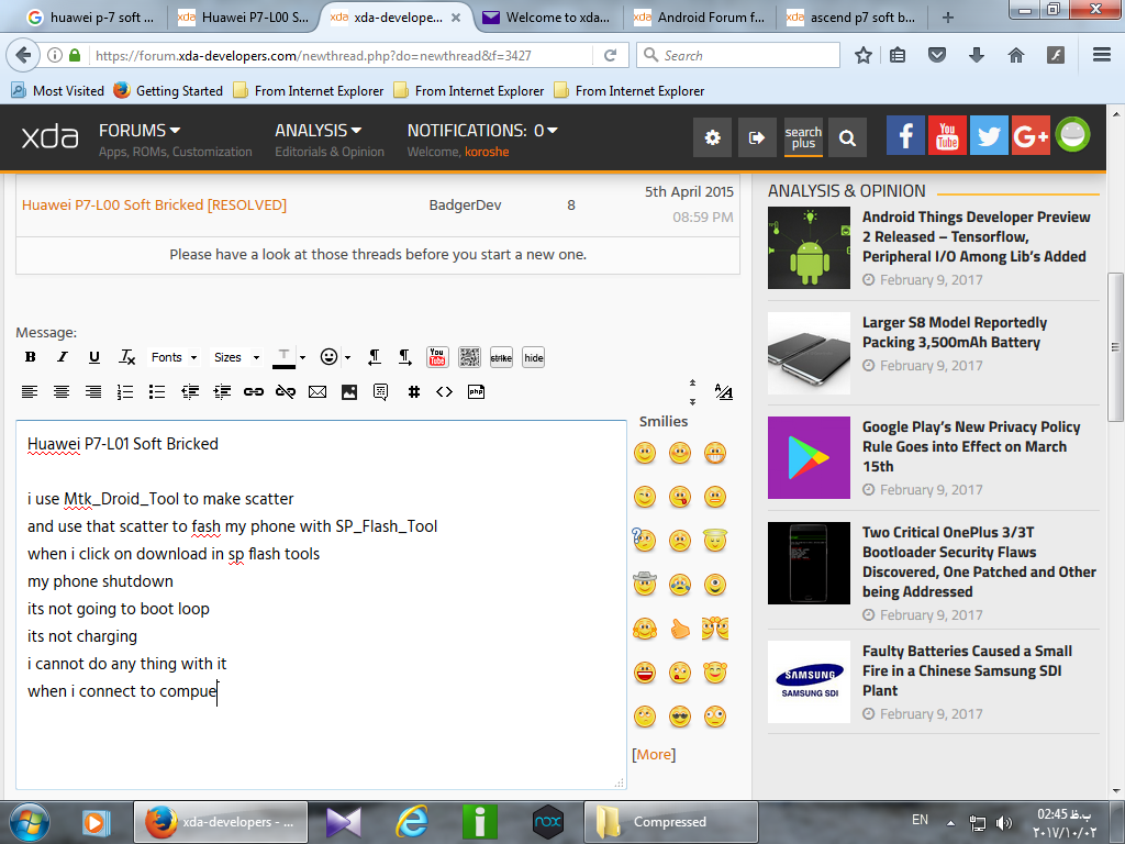

Huawei P7-L01 Soft Bricked
i use Mtk_Droid_Tool to make scatter
and use that scatter to fash my phone with SP_Flash_Tool
when i click on download in sp flash tools
my phone shutdown
its not going to boot loop
its not charging
i cannot do any thing with it
when i connected to computer huawei hisuit application recognize it but it can do nothing
please help what can i do???
