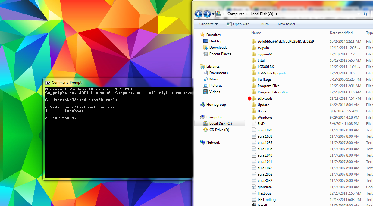

I install the drivers then I put the folder on the drive, and type the command but it show me a "?" when I press enter.
I'll leave a snapshot.
Looks like that may have worked actually. Go ahead and try a fastboot reboot command from that same location and see if the phone reboots. If so, we're ready to proceed.
