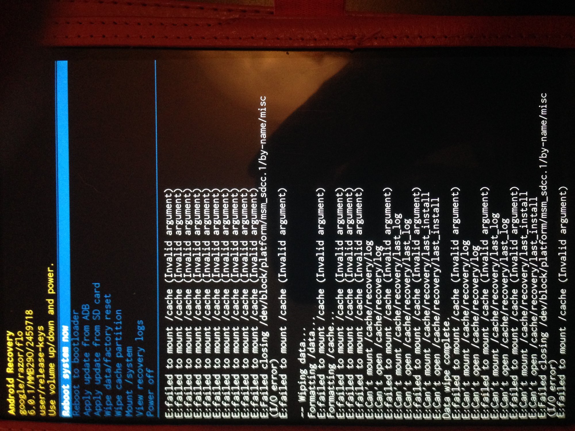

I am certain I'm trying the correct file for the one on the tablet as when I go into recovery from the bootloader menu it states;
Android recovery
Google/razor/Flo
6.0.1/MMB290/2459710
user/release/keys
So I tried a factory reset and after a while of saying
-----wiping data............
It came back with the screen below
Not sure what I'm doing wrong?
