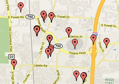

Problem with using aGPS was it bounced me around from tower to tower so much it made it impossible to keep track of. Maybe its because there are a glut of towers near me but it just made so much noise it was useless. You can see the log I posted earlier, just sitting at my desk at work every 15 minutes I was bouncing around a couple miles.

This is the locations logged just for one day while I was at work. I work in the small area bordered by 750, CR RD 10, Lazelle, and Sancus, see there are 4 pins in that general area, its a big office building with 10,000 employees so it quite a lot of space. If aGPS would get that close I'd be happy. The pins like the on on the other side of 71 aroud polaris/orion, or the one on 23 the ones stacked on worthington-galina road are all around 1.5 miles be the scale that map was drawn in. Those make aGPS nearly useless since I was no where near any of those points that day.
If the ones at or past 71 and the ones over by 23 and worthington-galena were eliminated so the accuracy was better I'd be happier with aGPS. Imagine if I were at work one night late and no one else around and dialed 911 from my phone and it said I was on the other side of 71 like that. To give a little more perspective, inside that oval road inside those 4 streets is the parking lot and a building that is 1/2 mile long. then over to the left between polaris and gemini is another oval going around a parking lot and mall, the mall building s also a 1/2 mile walk from one end to the other. not to mention all the other office and retail buildings around, they would never find me. So when someone said you shouldn't turn off aGPS this is why, its info is worse than none at all

Every few minutes. Here's Monday Dec, 7th. I was sitting in my office all day.
10:16 AM Columbus, OH
10:26 AM Columbus, OH
10:36 AM Columbus, OH
10:45 AM Columbus, OH
11:14 AM S Old State Rd, Columbus, OH
11:23 AM Columbus, OH
11:52 AM Polaris Pkwy, Columbus, OH
12:02 PM Polaris Pkwy, Columbus, OH
12:32 PM N High St, Columbus, OH
12:41 PM Gemini Pkwy, Columbus, OH
1:24 PM Gemini Pkwy, Columbus, OH
1:33 PM Gemini Pkwy, Columbus, OH
1:43 PM N High St, Columbus, OH
1:53 PM Gemini Pkwy, Columbus, OH
2:03 PM Gemini Pkwy, Columbus, OH
3:39 PM Newmills Ln, Lewis Center, OH
3:49 PM Gemini Pkwy, Columbus, OH
Notice how it bounced all around even though I never left my desk, those were the towers it was locating to. Now I would assume if your in an area with less towers it may update less since it won't change towers as much. I was going to attach a screenshot but the attachment button doesn't seem towork
