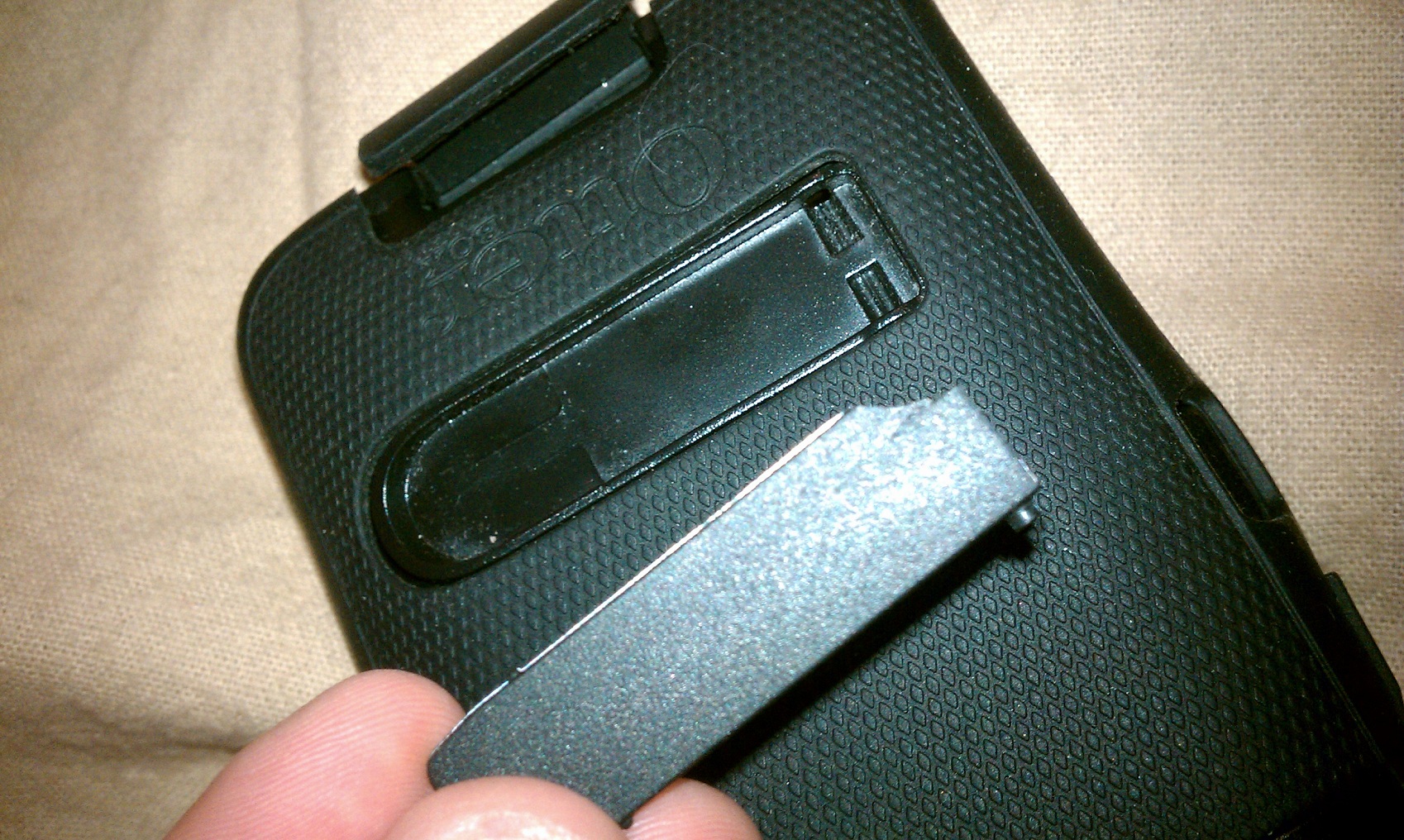

I bought the Otterbox Defender Case and was not impressed at all with the quality. The kickstand broke the second day and snapped off completely on the third day. Btw, I work in an office and use the kickstand to set the phone up landscape style...not exactly a rough atmosphere.
I called Otterbox and they said they will either replace or refund the money. I am leaning towards getting another type of case provided that there is one available. Last I checked the Ballistic cases weren't even out yet.
I really couldn't believe that this broke so quickly. :mad:

You're not the only one. I defended the kickstand the day I got mine and now I'm eating my words.
My kickstand is cracking and will probably break off completely if I use it much more. If you read the reviews on OB's site many others are having the same issue.

Ive put it on its kickstand like 2 times and no more. It already has a hairline fracture running down the middle of it.
Overall im a fan of the case but they got cheap on the kickstand.

Yep, my case is a few weeks old in total, used the kickstand maybe 10 times, and mine broke in that exact same place.
I wish they had just made a friggin stainless steel kickstand, like what the Evo has standard.
I dont even understand why they hollowed out the underside so much on that clip, just crappy design.

What amazes me is how it took them 6 months to design the thing and one of the most important parts was a complete fail. If you look at the stand, you can see they made it very thin in the middle (for no particular reason as it doesn't improve appearance or functionality). Anyway, the thin area is too thin and cracks. If they had just left the kickstand a solid piece if plastic it would have been fine.

Mine broke too...cracked...I had to super glue the pieces back and then put the kick stand back in the case. I love the case, but the thin plastic kick stand is kind of :(.

Mine finally broke off. Was the first time I tried to open it up after seeing the fracture.

Mine kick stand is now held together by super glue and electrical tape. It works, but I dont know. For a case that is supposed be a defender and the kick stand is this fragile?

I'm no engineer, but looking at how the kickstand clips in, I would have thought a better option than just giving away cases would be to stamp out some steel stands that have some form of pin that gets pushed out via a spring.
That way the new one could just have the pins pushed in on both sides, popped in place and releasing would allow the pin to shoot back into the 2 holes holding it.
