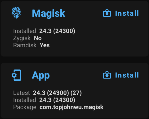

  • While the Magisk app is used for patching the boot image, the app and the patch are separate. This is what you should see in Magisk for functioning root:

  • "Installed" shows the version of patch in the boot image. If this says N/A, you do not have root access - the boot image is not patched, or you have a problem with Magisk.
  • "App" simply shows the version of the app itself.

does magisk show this?

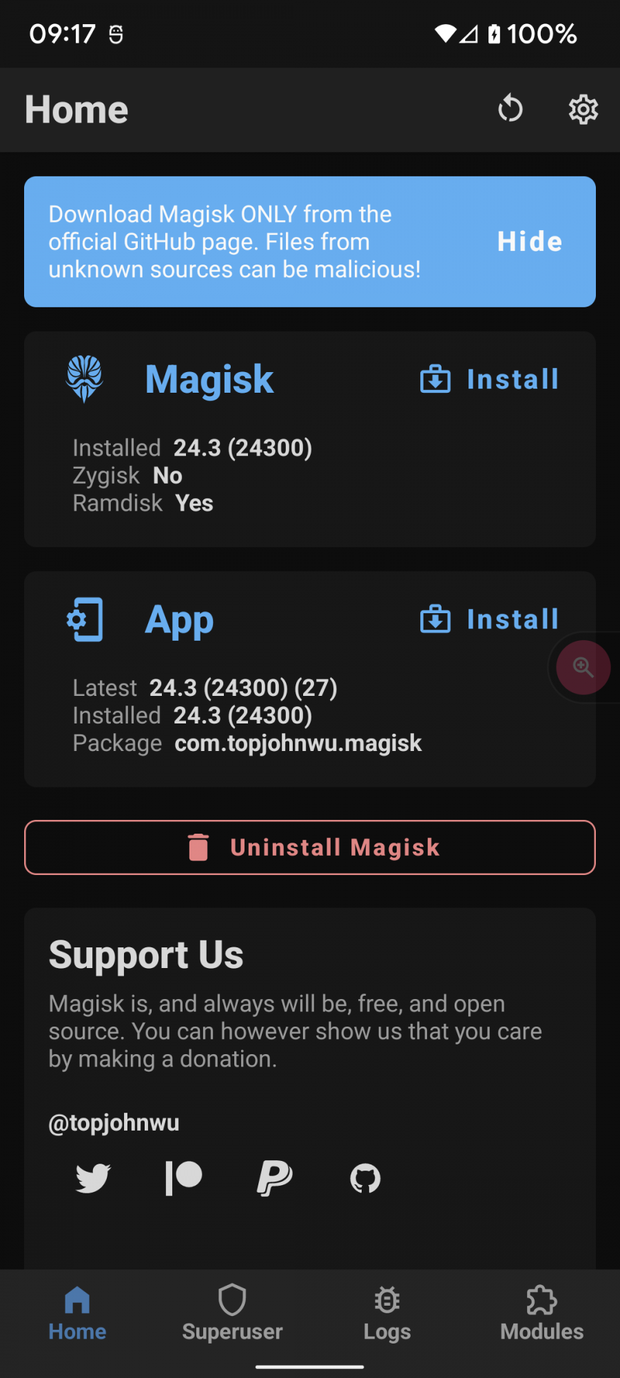

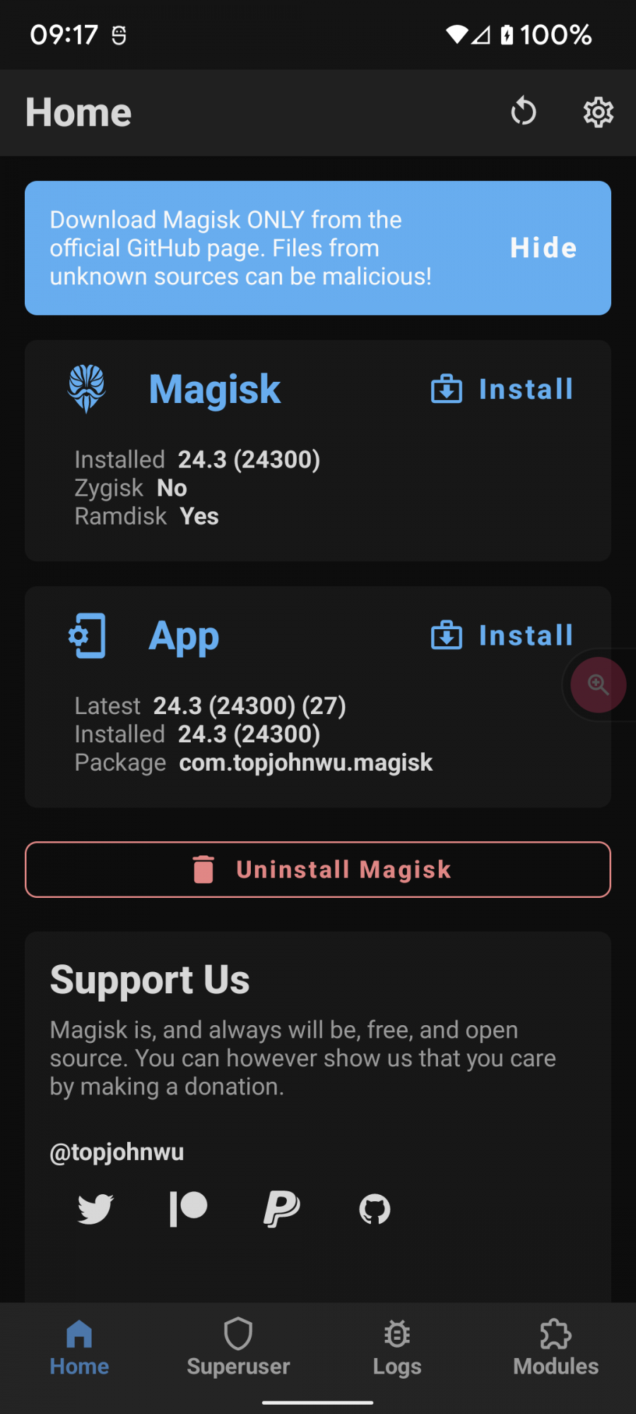

The boot image is patched and installed according to Magisk 24.3, please see attached screenshot. Maybe there is a problem with that version of Magisk ... can you successfully "su" with the version you're using?

  8. Android reboots normally. The Magisk app reports "Installed: 24.3 (24300)

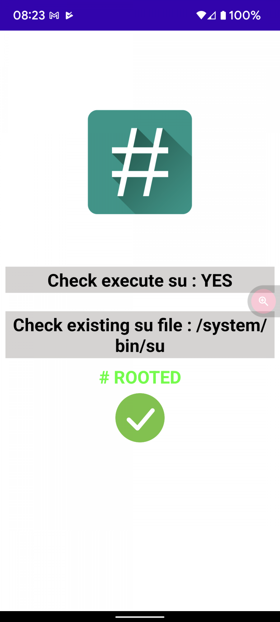

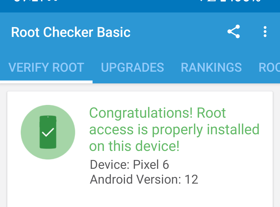

Yes, I downloaded the factory image and flashed the phone with it, then reconstructed my environment. The boot.img patched by Magisk is the one from that same factory image. A "Root Checker" screenshot is attached here.

I've flashed the most recent factory image, configured everything from scratch several times, all with same result of successful Magisk installation but without "su" capability.
