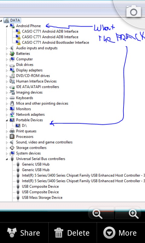

OEM Drivers install work for a short time then Breaks the drivers with error code 37. in other words MS sees the thing when online and breaks the drivers for som odd reason.
:mad:Just heads up before you try Win 8:mad:
Now its:
This device cannot start. (Code 10)
Freaking weird in Windows 8 is Schizophrenic.
Driver Management concluded the process to install driver wpdmtp.inf_amd64_8e480892a75ca191\wpdmtp.inf for Device Instance ID USB\VID_0409&PID_02EF\6&14250747&0&1 with the following status: 0x0.
Device USB\VID_0409&PID_02EF\6&14250747&0&1 was configured with oem1.inf (C771.Install.NT).
Device USB\VID_0409&PID_02EF\6&14250747&0&1 has a problem starting with C771BUS (oem1.inf).
How can it work right, then get squashed?

Yup tried that and it still failed. Windows accepted the drivers at first then toasted it.
It is Something to do with Windows 8 not Windows 7. if any one else is beta testing Windows 8 Give it a try. and see what comes back. Windows 7 works fine. and has no known issues.
It is Windows 8 that is all screwy, MS really did a number in the drivers department with that OS. So if any one else can load Windows 8 and test the drivers out let me know.
Again I say this is only in Windows 8.
the part not functioning is when you put the phone into charge mode. that is the thing that is broke. I have the mass USB Storage working though.
Like I said, Microsoft really changed a lot of things in Windows 8.
I have images, and Windows 8 is most definitively user Unfriendly. It has 2 ways to load the drivers. Legacy and the normal way. Tried both and windows rejected both even with these drivers from here.
It also deactivates the charge mode for the phone and the only way to get it to charge is through the USB mass storage device. again everything works fine in windows 7 , but Windows 8 has me gravely CONCEREND.
I hope this worked
Ok Here is the Video of a freshly installed Windows 8.
but before posting it I would like to get permission first. or let me know where I can send the video so that some can review it. I am sure after the video is reviewed, it might sway heavily on those wanting to try and use the beta version of Windows 8 Consumer Preview.
