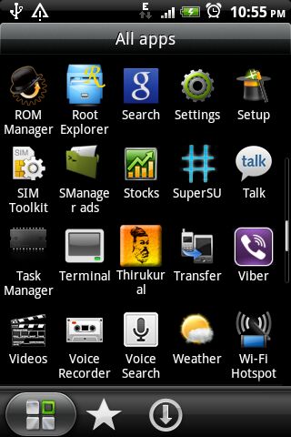

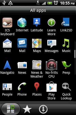

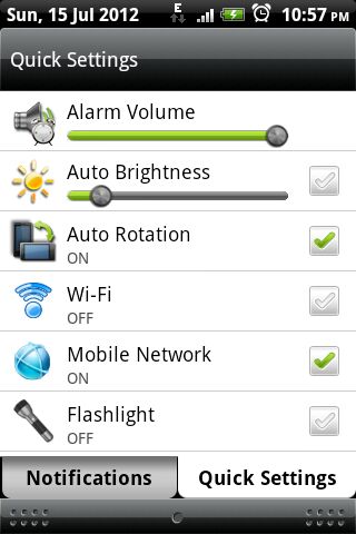

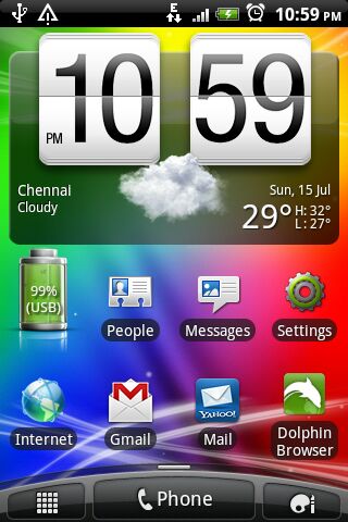

Now I feel(Back to Home), Got back the same HTC ROM with "MORE POWER" than the Original. This is what i was expecting to.....
It works perfect with more extended features. 106 MB is free now(After PRE-INSTALLED, Can't believe). Drop down menus are excellent. Link2sd is installed. More options on the 'power off/reboot' menu. Camera/video/Youtube/USB tethering and Internet Pass through are no problem.
More PRE-INSTALLED apps are like No-Frills CPU(Now Overclocked 806Mhz & FINE), SuSuper, Busybox, ROM Manager, GMail, ESFile Explorer, Root Explorer, Flash Player, Dolphin Browser, HTC Hub, HTC Likes, ICS Keyboard, WiFiKill and Youtube, etc...
With power+home capturing.....(see previews pics)
I was thinking overclocking would work perfect with CM only.
Now I'm becoming slowly pro in this area,
since LOT of VE's (VIRTUAL ENGINEER'S) are RESIDING HERE and guiding EVERYBODY on the right track... welldone "PHANDROID" for this support.
I Thank Caro, Slimchance [also CafeKampuchia's Guide] who are guided me to learn lot into this level....
Thanks again.

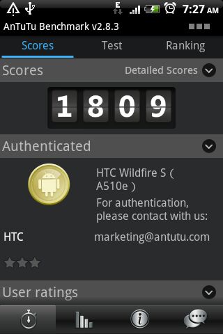

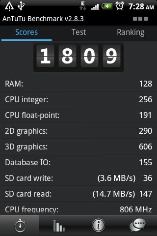

Excellent! Lots of internal memory, good Antutu score. What more could you want?:thumb:

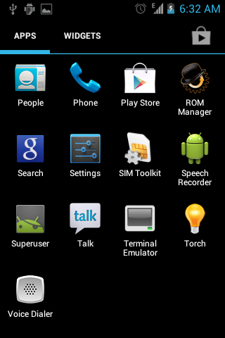

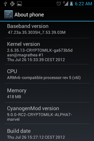

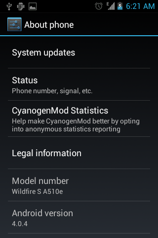

Update: Successfully updated to CyanogenMod 9 Alpha 7.
(After dissatisfaction with all ROMs, now moved one step ahead)
Hope more feed backs or questions...??!!
Wow - I'd be very interested in how you get on with CM9. Does everything work OK?
Does great. I don't believe that my phone runs on Android 4.0.4 !!!
I would recommend you to try this once.
can feel the difference. I'm still learning of the utility's...... As of now Link2sd alone installed.
Thanks to Caro for suggesting this!.:):vroam:
