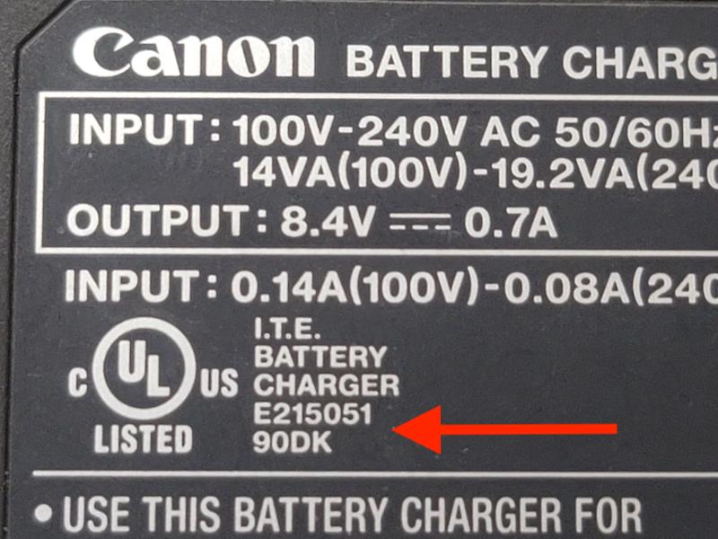

I believe UL approved electronics are supposed to have a number, that you can verify as genuine for the product. Same with FCC approval labels. No UL number, and it could well be fake?
Like this charger I've got, that was originally purchased in the US from Canon, and I assume won't burn my house down.
