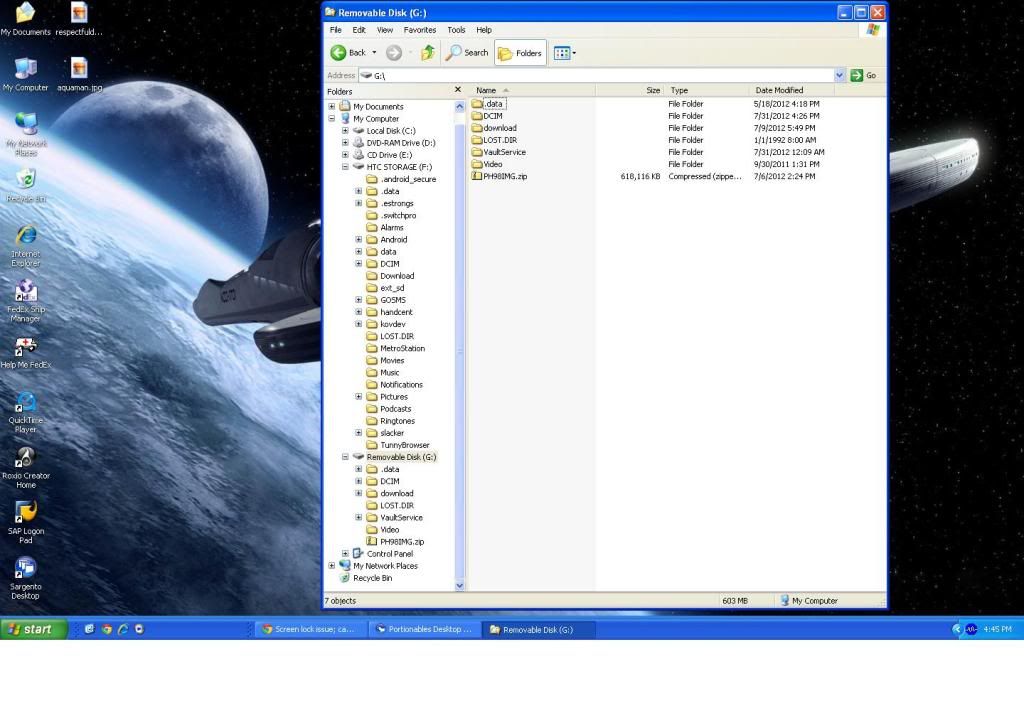

Yup, so far everyone I have seen having problems had S-on, PH98IMG.zip in the wrong place, or renamed it wrong .zip.zip
They figured it out and it worked after they corrected it.
If you connect your phone to a pc -- this pic shows which card to install the file too -- you can see both memory cards, you want the one that is 'removable'
If, instead, you are using ES File Explorer --> note the file path /sdcard/ext_sd (the system reports the card as a folder - I hate that) -- really messes people up when we keep saying "put it on the external memory card" and they don't an external card because android shows it like a folder >.<
and yes, file name of PH98IMG.zip.zip happens all the time -- should only be PH98IMG.zip
