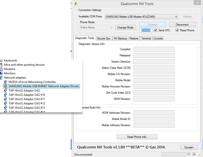

Ok... I'll get another cable. In the meantime, please take a look at this screenshots
Diagnostic com port should be a two digit number. Seen it as high as 26. Mine is 15. Looks like all drivers not installed. Yellow triangle. I think I got all my drivers with Kies but can't remember, I'm old.
hahahahaha! You're REALLY knowledgeable to be that old! I'll have to check if all my drivers are installed. Then again, when I check with Windows, it tells me that they're fine.
