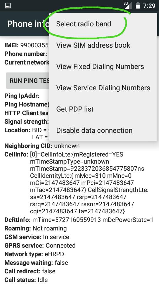

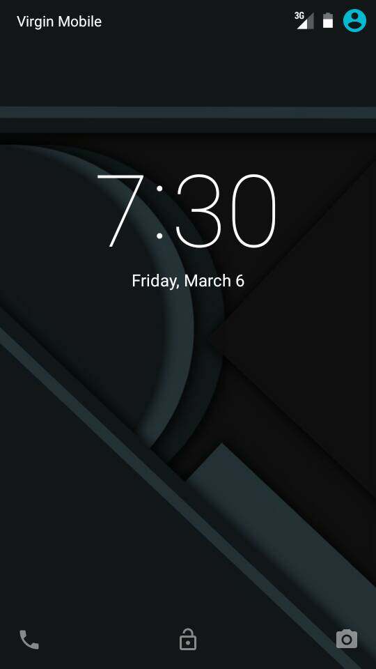

So I haven't been able to get LTE working on this ROM.
But I was messing with the settings in *#*#4636#*#*
And after several data and service issues I selected the following and rebooted...and now it does not say no sim or whatever it was saying before... Just virgin mobile now...still no LTE..but thought I should share
