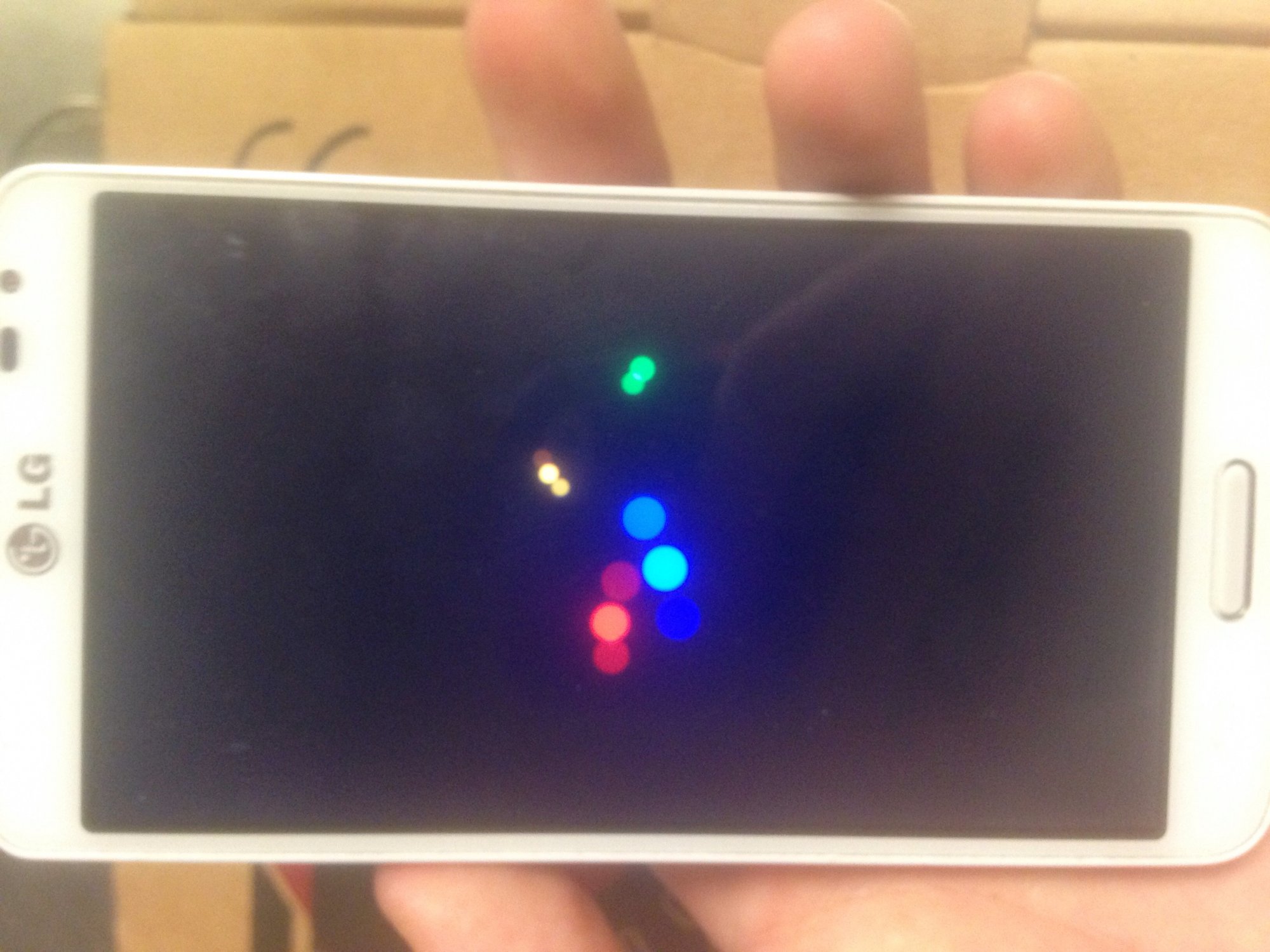

Pls help. I installed this onto my Lg Volt Virgin Mobile and the virgin mobile apn fix but when I went to reboot the system after the install I'm getting the 3 moving balls bootlogo but it's looping. I left it for 20 minutes. I also forgot to set a recovery so I have no way of going back. Is there a different rom I could install???
You must've flashed the wrong APN fix. Also, the recovery stays. You dont have to set another one. It's still there. See if you can try to boot into twrp. Pull out the battery and do the button combo. If your able to get into the recovery, do an advanced wipe, except the external sd card and redo everything without the apn fix. This should work.

Ok I'm having trouble with just getting this rom running. I've flashed the rom using TWRP and Sideload along with the radio fix zip, but when I go to boot the phone it gets stuck at the boot screen where the colored dots are moving on the screen. It just stays there and I've left it for a good 20-30 minutes, but it never gets past it. I have no idea what I'm doing wrong. Any suggestions.
Just tried this. Works great but two major issues that I had were I am using ringplus and couldn't find an apn fix for it so service wouldn't work and in candy settings hardware buttons menu wouldn't open (fc). Switched back to stock. If anyone can help me with those things it would be great and I would be able to use as daily driver. Thanks
You wiped data, cache, and dalvik?
