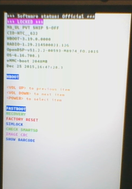

Thanks Harold. Can you take a look at the picture below and confirm is it S-off and I can install stock ROM which I was able to get from the above mentioned link and it also matches my phone's Radio?
HTC_622 is a HTC Asia (Hong Kong) handset, so I wonder whether this one (from AndroidRUU.com) might be better: RUU_M8_UL_L50_SENSE60_MR_hTC_Asia_WWE_4.19.707.2_Radio_1.25.21331147A1.06G_20.69.4196.01_F_release_414204_signed.exe 1611.4MB 2015-05-24 23:38:58
I'm just wondering about the radio firmware here: a US M8 probably supports different radio bands, so I'm not certain about compatibility.
(I think that the photo says HTC_622 - it's very fuzzy).
It is indeed 622. I am honestly worried that I might turn my phone into a brick. RUU that you provided, will it work? As I have no idea of compatibility. Just learned some where that Radio code should match RUU.

I believe you are talking about your bootloader being locked which is fine. S-off pretty much trumps an unlocked bootloader.
I'm not 100% certain that the RUU will be exactly what you need but I don't think it will hurt your device either. I'm pretty certain it's the software you need but I couldn't verify the radios.
The ruu I linked comes directly from the HTC website. They didn't break out the RUU into separate regions for the unlocked variant. They just have a single one called Unlocked/Developer
But if you look at the top left of your screenshot you can see the model is M8_UL and the RUU is the same.

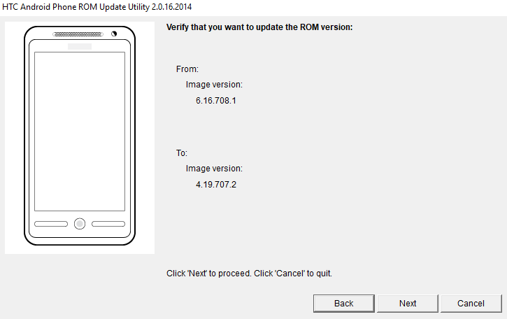

I am in the process of reinstalling Asian version of RUU.
The current and Updated version are different. Should I go for it?
It is a downgrade of the software, but we couldn't find anything newer from that region.
Personally I don't know whether this will fix any of your problems. I expect that being S-OFF it will let you flash it (it wouldn't otherwise), and I haven't any better suggestions, but it might just downgrade the software and achieve nothing else.
