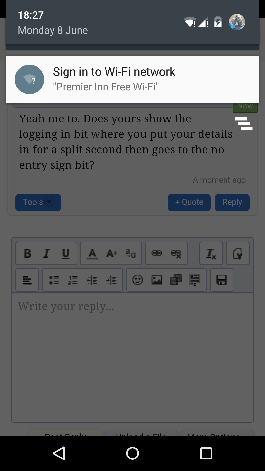

I've added pics. To try n exain it to anyone who doesn't get me.
1) first click on the sign in then,
2) it loads and then then the no entry sign appears
Ah, you are missing a step
When you get the red sign, click on the 3 dots top right and select "Use this network as it is"
Then go to Chrome and access any site and you should be redirected to a sign on screen

Thanks for your help, will give this a try :)
This is a hotel, they could be using a proxy to insert their own ads into webpages, and Chrome is determining that it could be a man-in-the-middle attack, which is basically what local ad insertion is. I've seen it before with hotel networks in China. A secure VPN would very likely fix it, that's what I use.
It's interesting that two people have come in about the same time, same problem, both Premier Inn. So probably it is something that this particular hotel chain has done with their network, like using an ad proxy.

It didn't work unfortunately.
So this issue wasn't resolved, perhaps someone technical at Premier Inn and/or Arqiva needs to become aware of it and needs t0 fix it.
Almost certain what it is, their proxy is manipulating SSL data packets, probably to insert ads, and Chrome is red-flagging it as a possible man-in-the-middle attack. Internet Explorer on Windows, which is probably what most people use, may not even be detecting this, nor Safari the default browser on Mac or iOS.

Thank you Mistergoof that did the trick. Exactly as you said. Although I didn't need the advanced bit. I still get the red sign but now at least I know how to bypass it.
