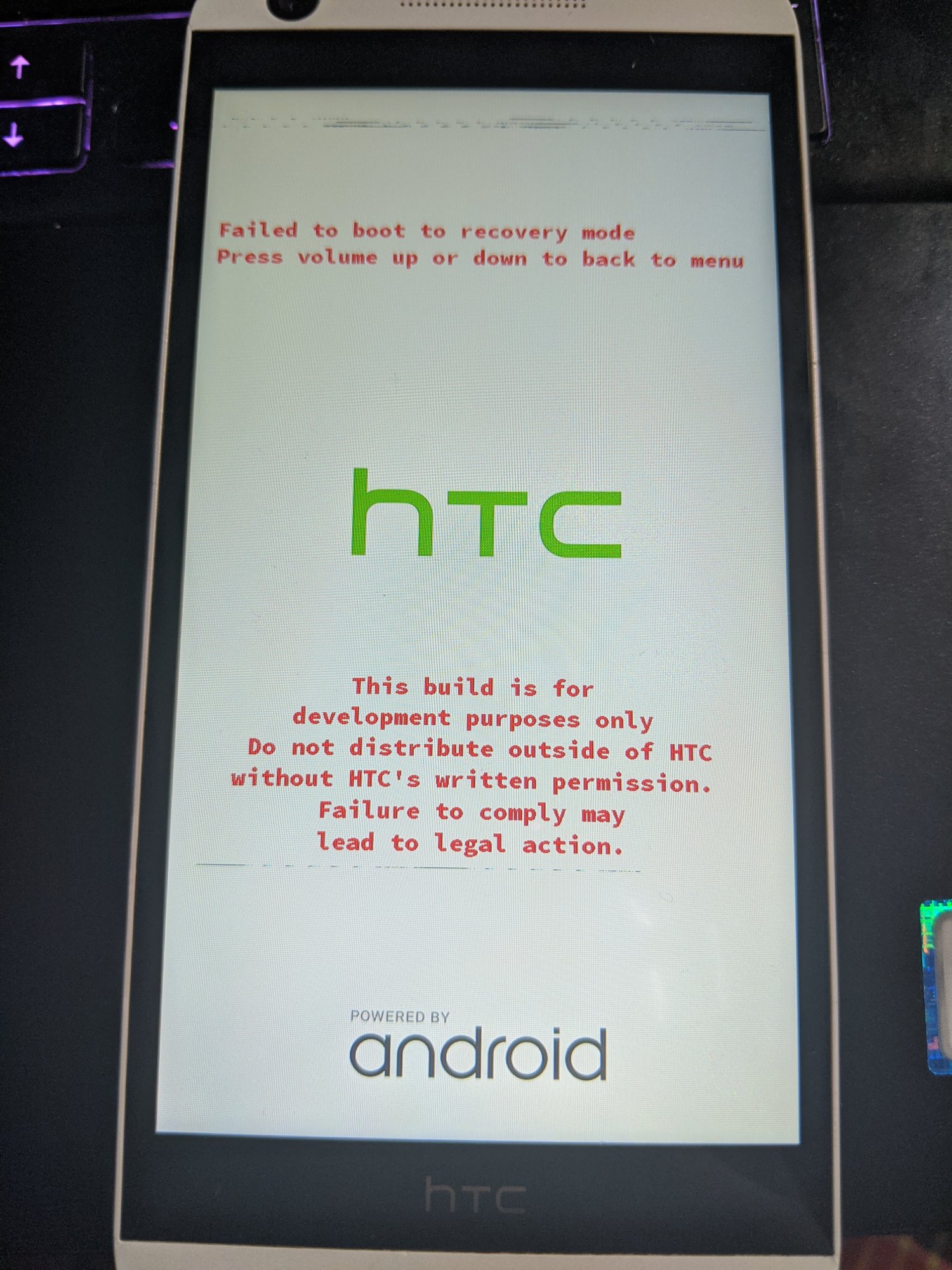

I found my old phone earlier today while I was re-organizing some things, and decided to turn it on for laughs. After discovering it still powered on, I wanted to see if I could unlock it and get it fully working. However, I can't even get to the point of unlocking the device (see pic one). After some research, I said screw it, and tried doing a hard reset, but I can't even get into recovery mode, and I don't have an option to factory reset this thing. And of course, when I tried to use the HTC RUU for this thing, that ends up not working either. Has anyone else ever ran into anything like this before?

The funny thing is that the third shot tells us that the phone *has* been modified. You only get that red text on the splash screen after modification, so at the very least the bootloader has been unlocked at some point, even if it's locked now. And whatever was done then might be relevant to the current problem.
Also why is it in safe mode in shot 1?

In all fairness, the bootloader was unlocked at one point, however, the phone's never been rooted, flashed with custom roms, or anything of that nature. The phone is running on the stock HTC rom. Having unlocked the bootloader still wouldn't explain why it can't seemingly be factory reset.
I rebooted it into safe mode to see if there was anything 3rd party that could be causing the error. The result is the same on normal startup, so that told me what I needed.
It's worth mentioning that occasionally, it'll start to show a stock wallpaper, and it even showed my Homescreen with no wallpaper once, but the same error still occurred.
If the recovery module is borked that would imply either some attempt to flash something or else a failure of part of the system storage.
