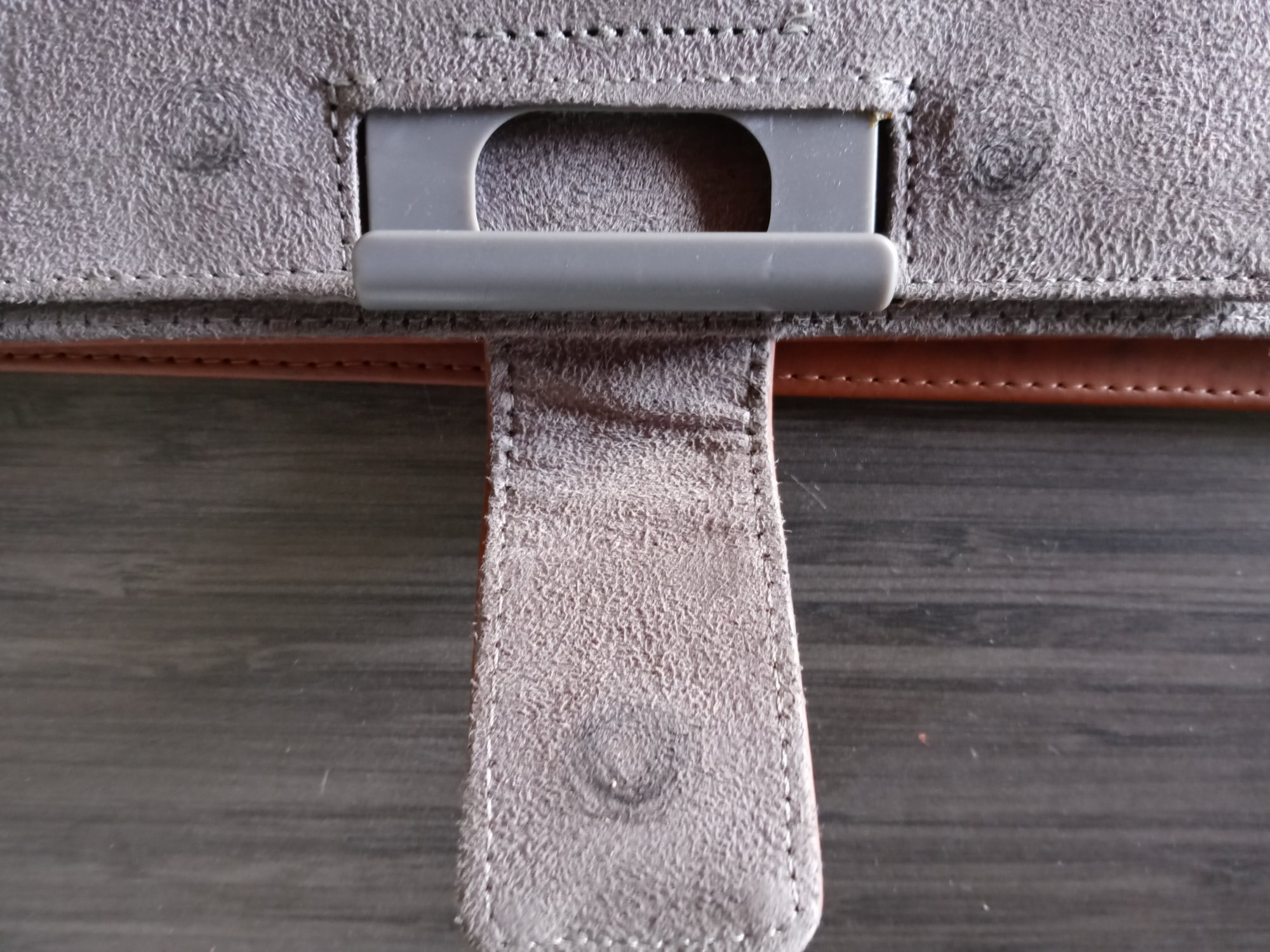

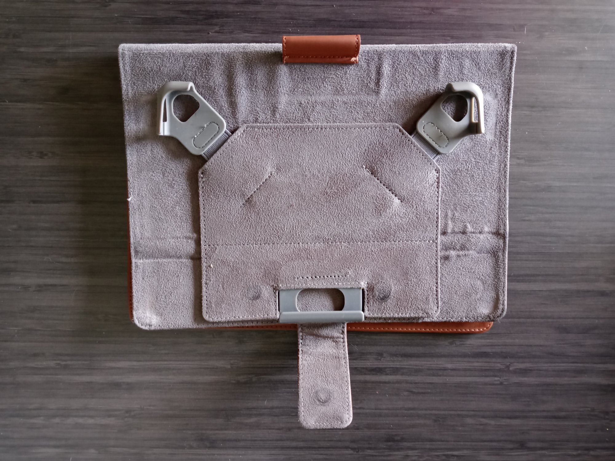

Now after a lot of investigating i have come to the conclusion that the case i have has a slight magnetic strip along the edge which holds just enough to keep case closed, this magnetic strip tells the front facing (as you look at screen) camera that the case is shut so the screen turns off automatically thus saving battery life, however, it has the same effect when the magnetic edge is placed over the rear facing camera, voila the screen turns off.
conclusion...this problem has also been documented with the official Samsung case which, i might add, costs considerably more than the one i have so if i wish to keep my tab in top condition i guess i have to live with it.

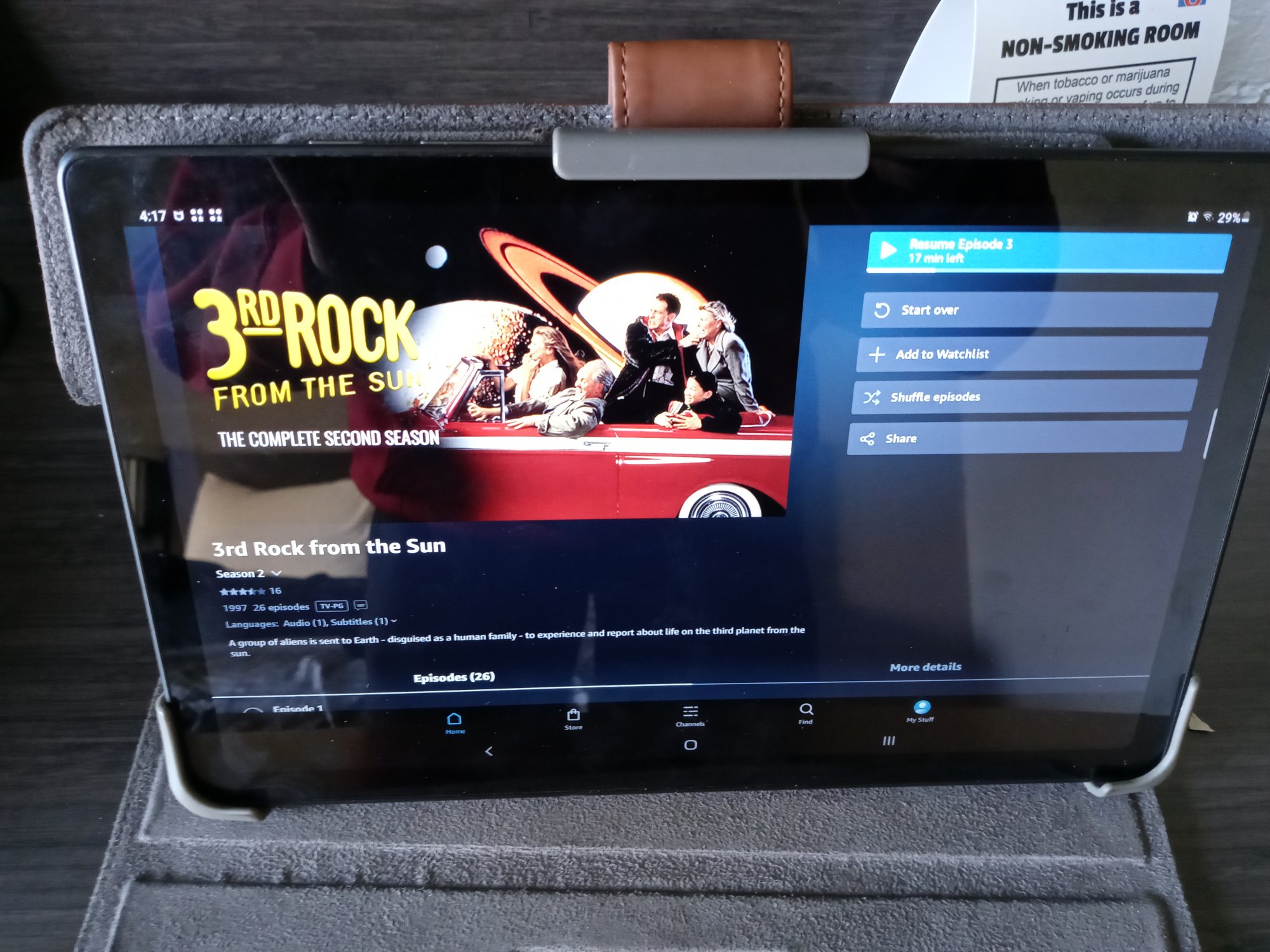

I have a Kindle 10, and several covers of different designs and manufacturers. I just had this same problem while at a conference. While I held my Kindle off my lap, it worked. As soon as I folded the cover in half and placed it on my lap, off would go the screen. I googled this problem, which brought me to this page. I have found that as long as I have the Kindle open like a book, I have no problem. Interestingly, I have the exact same (design) cover for my Kindle 8 which does not do this!!

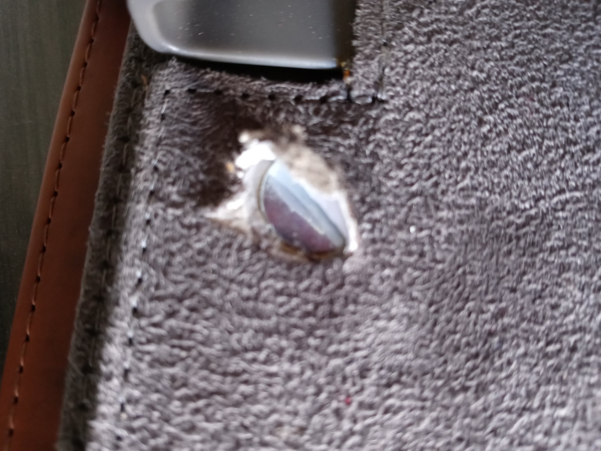

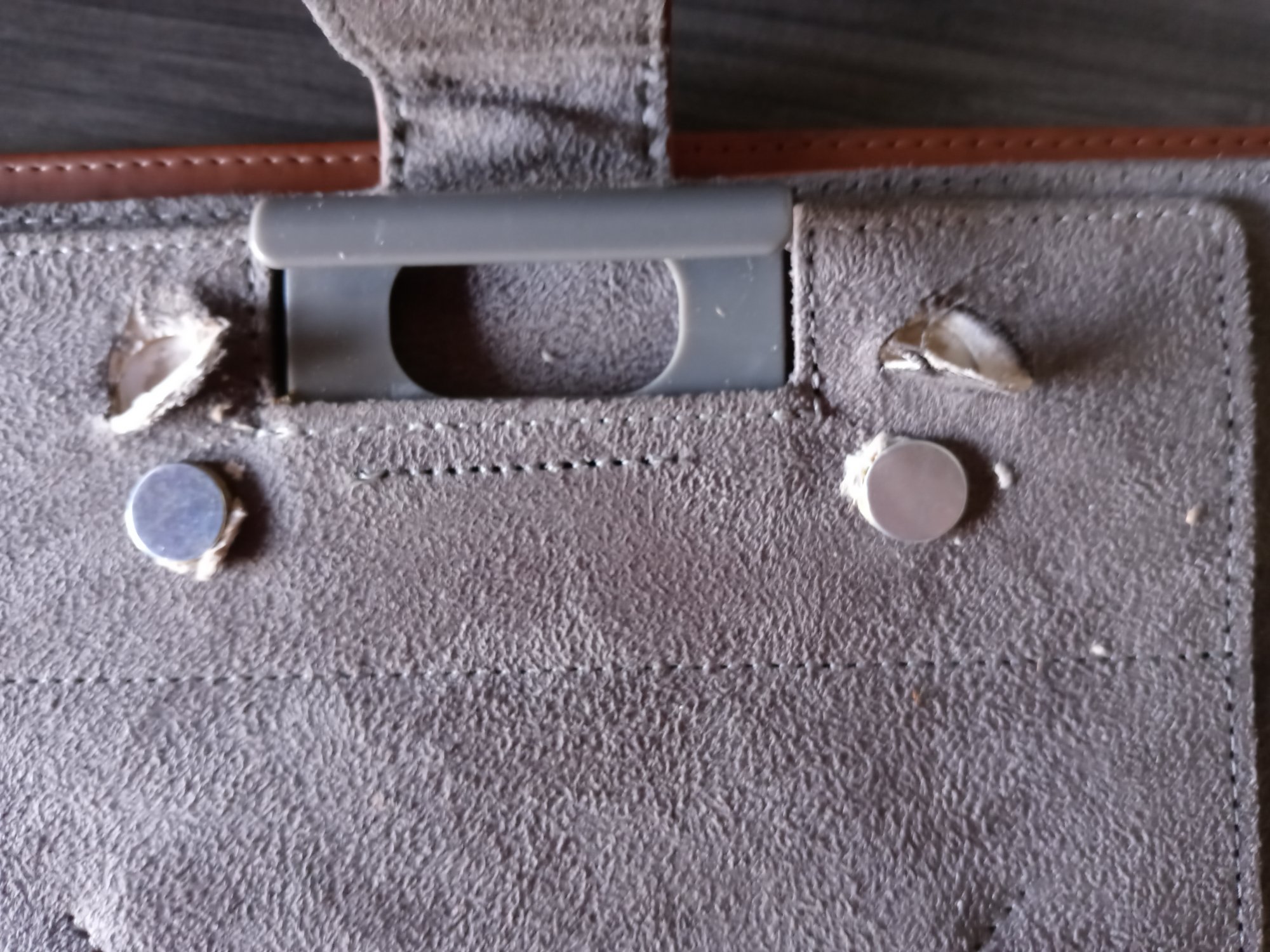

I had the exact same problem. Never thought to go poking around with a paperclip to hunt two magnets which where pressed right up against the tablet. What kind of shit sack degenerate engineer puts useless magnets directly in line with a device? Tablet now works as it should.
