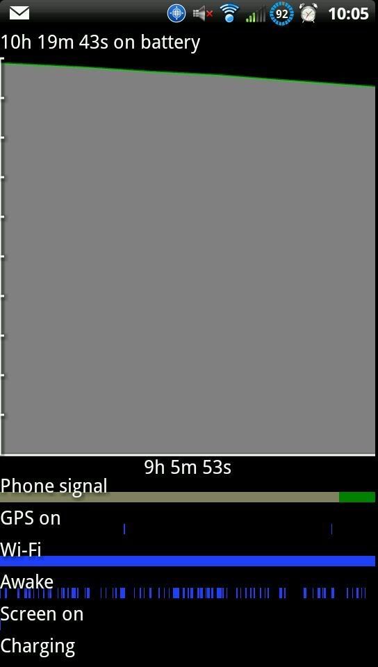

Yeah the wakeups are very short and uniform. Battery life seemed fairly unaffected but I'm still confused by what keeps waking the phones.
I'm really suspecting the carrier spyware (although as I write this, I haven't confirmed that yet), hence my desire to just try out freeza's kernel.
Ah I hadn't tried that. Gonna give it a go and see what happens.
Edit: Well I installed Freeza's kernel and used Titanium to remove the two iQ programs I saw on the list and it doesn't seem to be doing it. I've only had it on here an hour though so I'll give it more time.

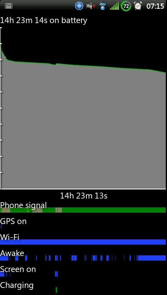

This is a screencapture of last night. I left it off the charger and obviously wasn't using it.
Interestingly, in the previous screen it said it was only awake for about 24 minutes. That makes me think it must be some sort of "behind the scenes" process, which could be the phone finder but then they must have broken it from 2.3.3.
Edit: I just checked my router and there are little blips throughout the night, so the phone was doing something on the network...

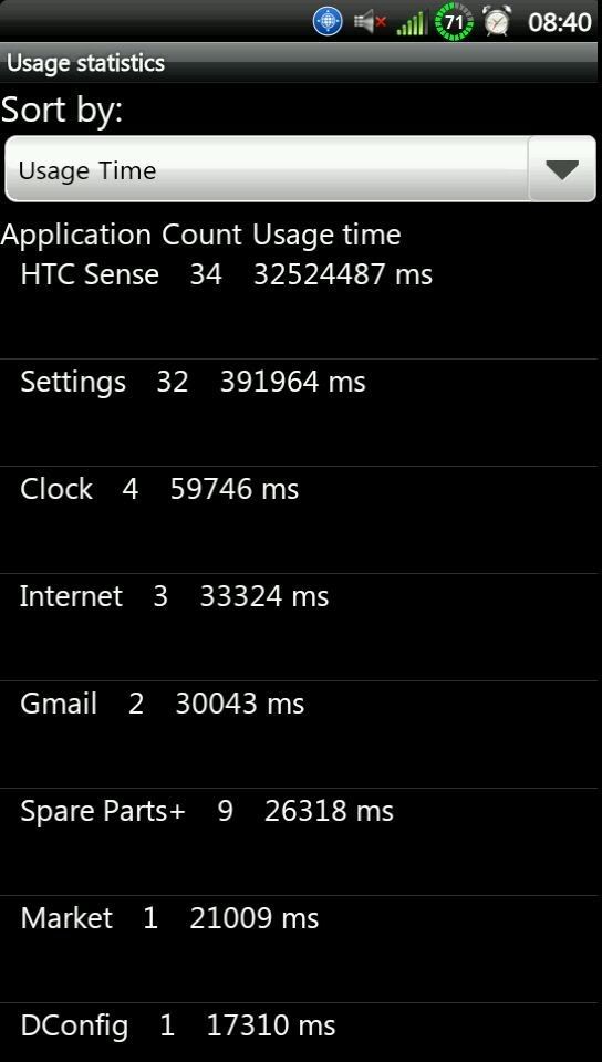

Well I let it run overnight again, this time with Synergy r334 and this is what it came up with
I've no idea why sense is using up so much processing time. I guess I'm going to install a rom and leave it app-less and see if that results in anything.
