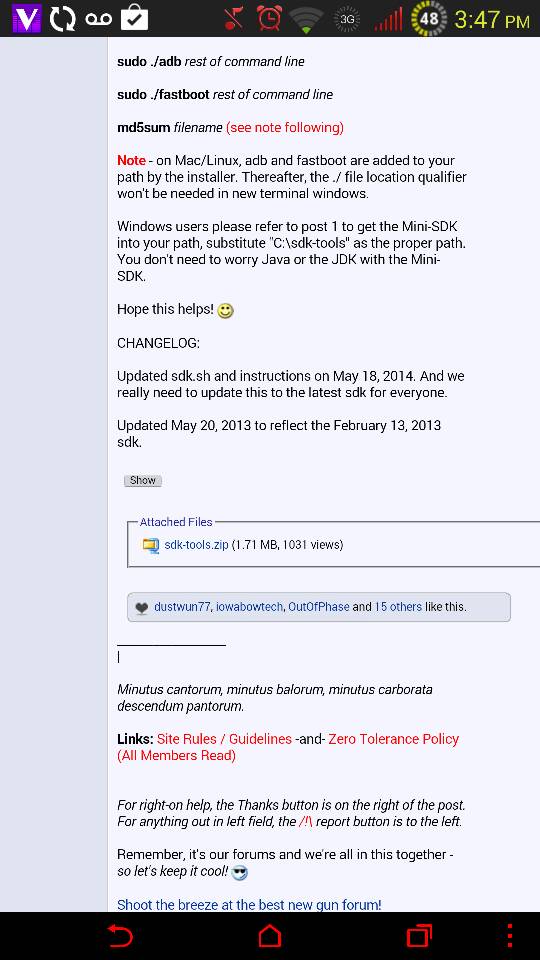

I believe that's the link I tried before. Here is the message I get...
Invalid Attachment specified. If you followed a valid link, please notify the administrator
I get it in both Safari and Firefox on Ubuntu. Must be something other than a cache issue?
It's not just you. I tried with three different browsers and got the same error
