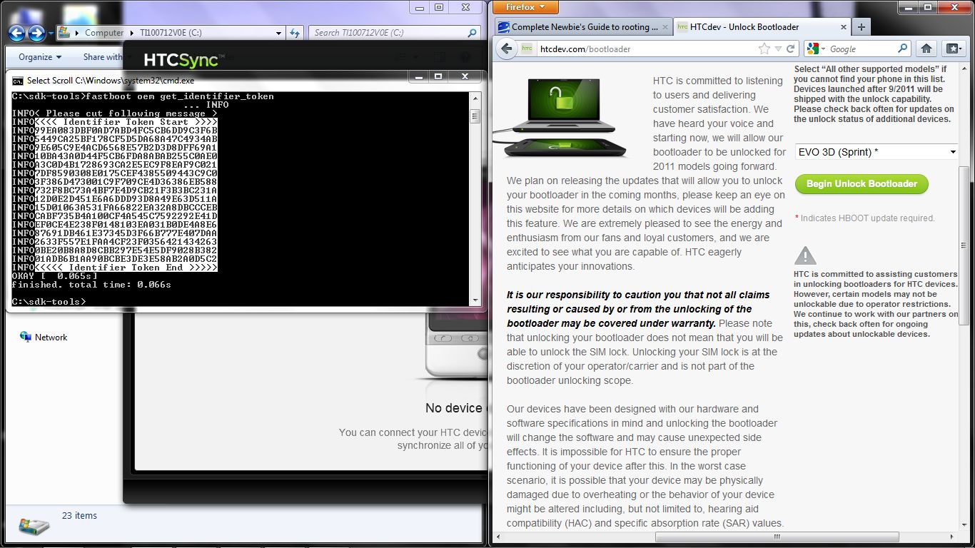

This is great, but I get stuck when trying the HTCdev unlock bootloader. I click to start the thing and nothing happens. There is an asterisk next to Evo 3D indicating I need to update my bootloader.? I am in FASTBOOT USB in the process and it show my bootloader as 1.50.0000
Help. What do I need to do?
Do not copy the "<<<< Identifier Token End >>>>" line and try that.

I don't get far enough to even paste that token anywhere. I get stuck when I try to run the unlock bootloader at http://htcdev.com/bootloader/. It won't execute on my home PC with Windows 7 or my work PC with Windows XP. I click the button and nothing happens. I contacted them and we'll see what they say.

It seems to be a browser issue. At home I was using Firefox. At work I was trying Chrome. I switched to IE8 and it is working so far.
