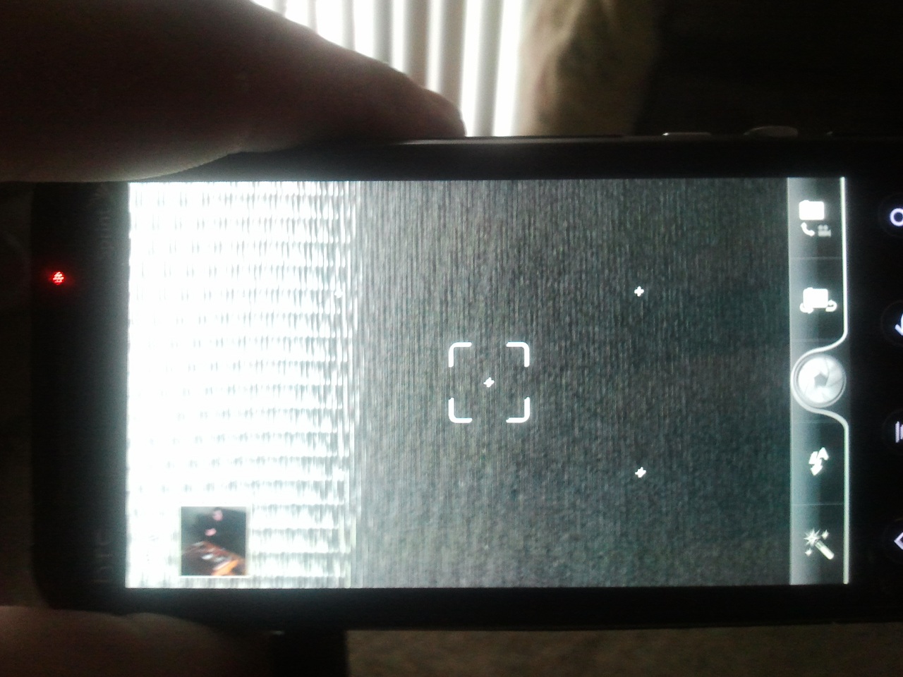

my evo 3d has done this since flashing.
anyone have an idea?
this pic is taken during the camera app, it just dosen't show the camera display properly? the screen works, you can see the gallery thumbnail... so i dunno
it does take 2d and 3d photos and display them properly
thanks in advance

We'll need to know details. Like is this an OTA update, or is this a custom ROM...and what kernel you're using if you're using a custom ROM.

ive used several roms, currently warm 2.3
kernel ver : 2.6.35.12-g277012f
also i get an error under the wifi enable / disable option
I'd say it has to be a kernel issue, and if not I'd just try to reflash the rom. I am currently getting ready to flash warm 2.3 so I will see if it does the same thing to me.

reflash didnt work, tried infected rom and synergy rom and miui, all the same issue in the camera app the screen is a bit odd, but the screen works, and it takes 2d and 3d pics, you just cant see them from the camera?
gonna try a different camera app and see if its just the roms app
The camera problem is likely your kernel. Flash the stock kernel. If you don't have it on hand, I can probably dig up a link for it.
