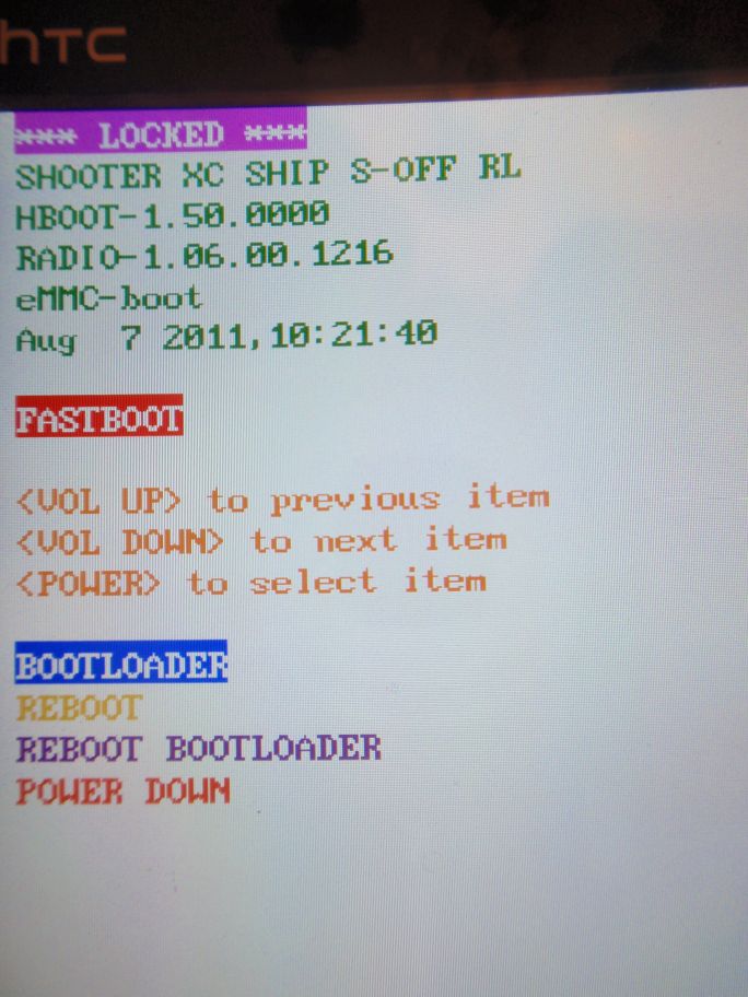

Another one for proof, quote below with pic
got it on second try, used stock rom but after tool was finished i restored zr3d 3.0 gt and it acctivated with no issue. Thank you guys so much for all that you do for us.
