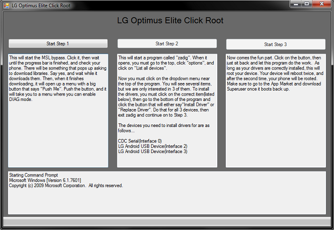

Step 1-Download and install the default LG Drivers(Must install before you do anything else)
Step 2-Download file, and extract the .zip to "C:\android\platform-tools"
Step 3-Run the Program. It's called LG Optimus Elite Click Root.
Step 4-Follow the instructions, and when you finish download superuser in the market.

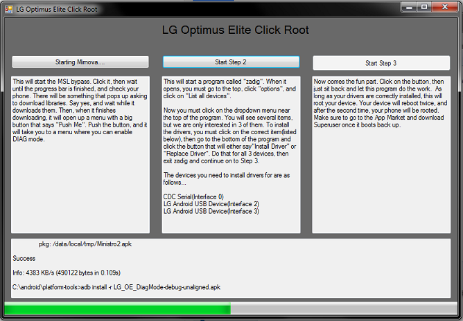

The verifier is working for me now. When I run giantpune's method step one, it works fine for the first click. After the first 'continue', it displays the following towards the end:
Code:
$ am start -n org.kde.necessitas.example.LG_OE_DiagMode/org.kde.necessitas.origo.QtActivity
Starting: Intent { cmp=org.kde.necessitas.example.LG_OE_DiagMode/org.kde.necessitas.origo.QtActivity }
Error type 3
Error: Activity class {org.kde.necessitas.example.LG_OE_DiagMode/org.kde.necessitas.origo.QtActivity} does not exist.

Lol, no problem. Thanks for trouble shooting it. Those lines mean are the commands that try and start the Ministro app that gets your phone ready for root. Make sure that your debugging mode is on, and watch your phone. Dont let the screen dim and dont have it locked. Also, go to the phones settings>applications, and check the box that allows installation of non-market apps.
