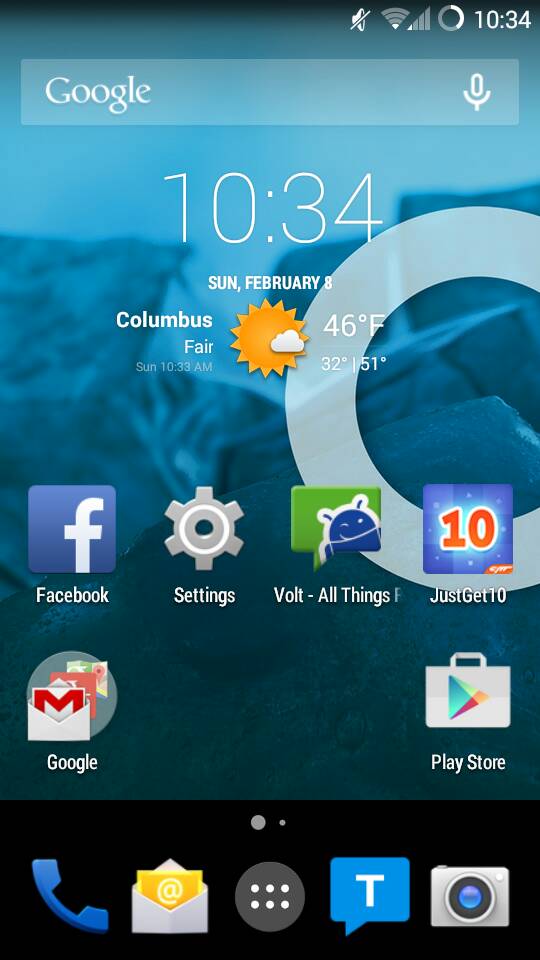

Running this since you posted and 4g comes on every time. It doesn't seem to be as quick as is was on stock but I don't know. Calling works fine and no issues with sound.
I do see a small graphical error every few hours where the bottom of my screen has a black background, see pic.
All in all its pretty much ready to be a daily driver.
Forgot to add pic
