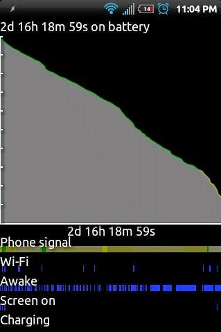

I'm using an AceSoft 1840mAh battery that I got from Amazon.
So far it's doing good.
If you get a new battery, make sure you leave it charging for a few hours even it it says 100%. Then let your phone drain completely. That calibrates the battery so that it gives a correct reading. I would suggest only letting it completely discharge ONLY one time since discharging completely lowers battery life.

That's enviable battery life, surely. Do you use 3G at all?

I use 3g and WiFi, but I also have a Tasker profile set up that turns them both off when the screen goes off unless something is downloading. If anything is downloading, it waits until the download is done before turning them off.
I hadn't used my phone much for 2 days before taking that screen shot, though I did make a few phone calls near the end. So, it's not really a good indication of my battery life with moderate to heavy use.
If anybody is interested, I could export the Tasker profile I use to XML and upload it.
