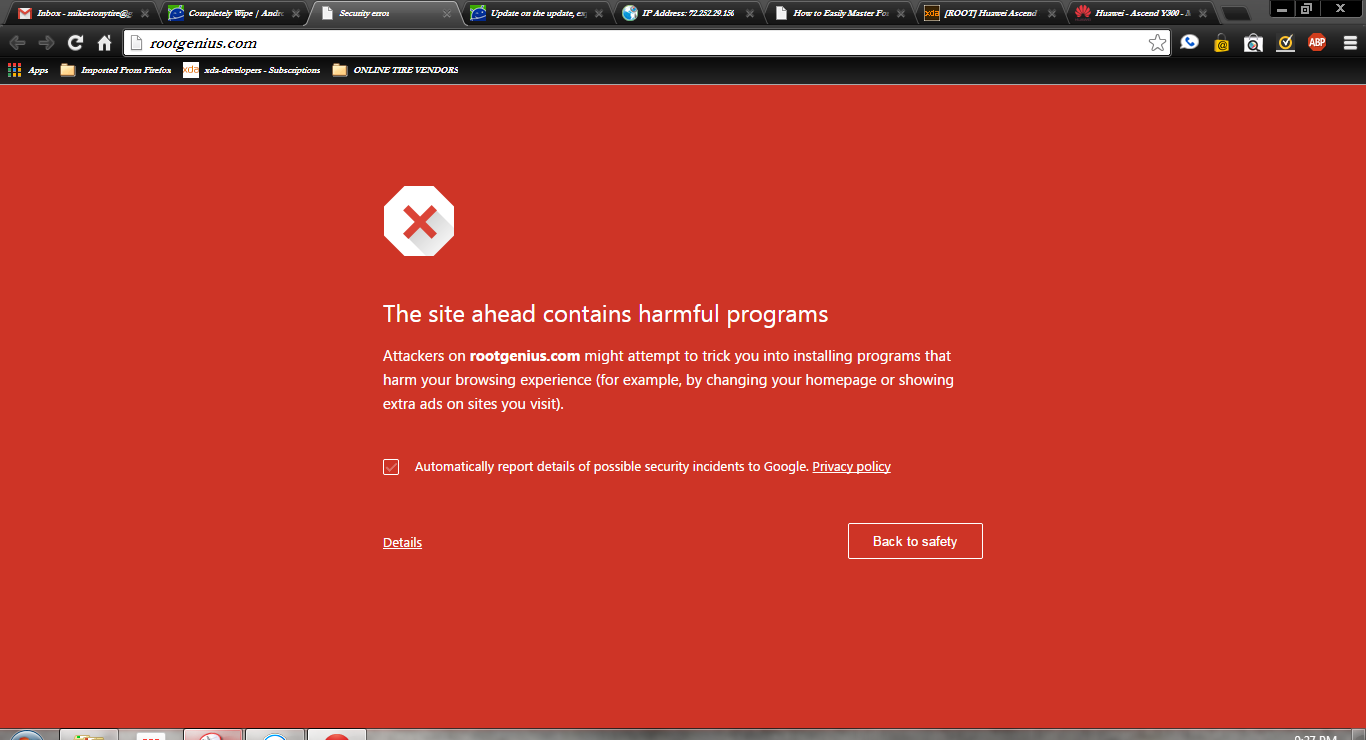

Err, my computer just flagged that site. Is it cool on your end?
Not cool on my end

The website is okay, the program it is talking about 'rootgenius" will use your PC to overwrite data on your cellphone. it has to in order to be able to do its' job.
AV programs do presearches on a weblink to seek out words, or possible "nefarious" hidden intents.
Use a different AV program that you utilize from the web and supply the link to that program. ie, AVG

Guys hold on... i cant access the site
I am using Avast 2015 and i shut it down and yet still i cant access it
giving me the same security error
