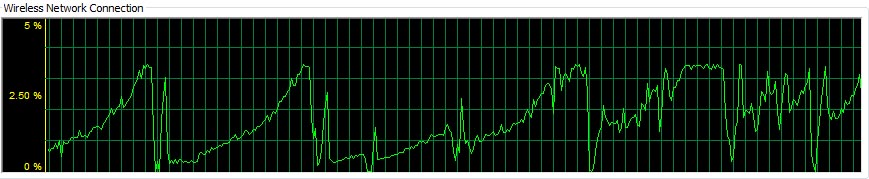

Same problem here. Below is a screen capture from my PC's network utilization monitor while streaming a steady stream using my Slingbox. I've had identical results several times before.
It drops to zero, almost at well defined intervals, around 30 seconds. I get close to 2 MBS, then a quick drop to nothing, then a climb back, and repeat. I'm on 4G with a good signal. And it stays solid if I tether. Don't know why Verizon would intentionally do this. Seems they'd rather cap it at a slower steady rate.
My guess is a phone thing that uses the network at regular intervals and shuts down hotspot communications. Sounds like a software fix.

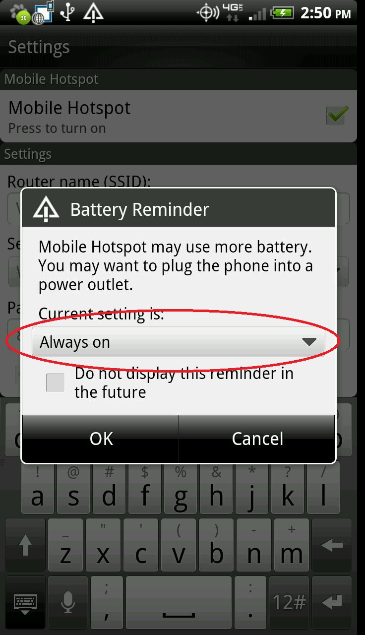

I still think it's people not setting their phones up correctly when enabling it. Is everyone turning their setting to "Always on"?
That's only related to the actual hot spot connection being persistent. The issue I am having isn't with a hotspot disconnection, but 4G disconnect during hotspot.
