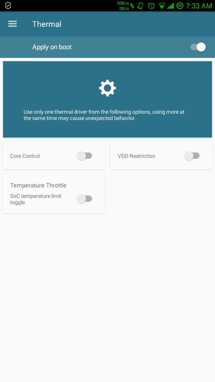

OK. I found out how to get past the thermal throttle.
You have to navigate through you system folder and rename or delete a specific file called libthermalioctl.so
I also used kernel adiutor to turn off the thermal control options to finally make this successfully run at top speeds even when charging your phone.
Can anyone make a build prop entry or some kind of customs script that disables these options on boot? It would save space, ram, CPU usage and battery power instead of using a kernel control app to shut them off.
