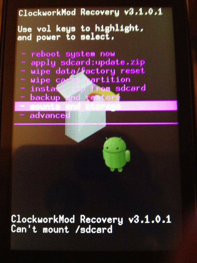

Hello all. Right now i am running rooted stock rom 2.2.1 and I am having trouble mounting my sd card in cwm recovery. I can mount my sd card while the phone is operating but I cannot when i want to make a backup or when i want to flash basix. I have flashed between roms before and have applied electric sheep with basix. Could this be from the latest rom manager update?

Hmmm... wish I could help you out. So when you go to install zip from sd card (in orange cwm) there's nothing there or you don't even have that option? Or what happens when you go to backup/restore?
Heres some pics of whats going on

Dont have a spare sd card should i just wipe and reformat mine. i have all my data saved alread i just didnt want to wipe my card.
If that's the case then by all means format it. If it still doesn't work, before buying a new one, check if you have any friends with a minisd card and ask if you can test out theirs on the spot to see if that error still pops up.
If it still doesnt work then Odin it and reflash cwm.
Thanks everyone yeah i formatted my memory card last night and everything started to work fine. Now i got a backup and flashed back to Basix
