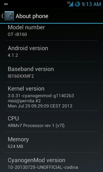

I probably have done something wrong because my version still 4.1.2
Every thing work as it should thou. I'm very happy, its like getting new phone...
No, you haven't. You followed the exact instructions here and so you have Cyanogenmod 10, not 10.1. I'll add the links for 10.1 when I get the chance if you fancy giving Android 4.2.2 a spin. Still glad you're enjoying Cyanogenmod on your Ace 2 :-)
Oh... I see, here is my screenshot..

Well the links to the CM10.1 files are up now. You can install it in very much the same way as you did version 10.
