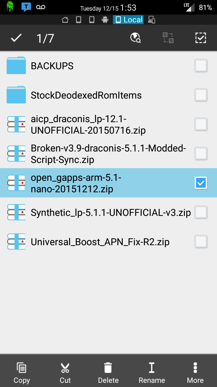

What is the differences between the 3 different roms to download? Using the AICP ROM right now... Really liking it, expecially the themes and stock tether. SO MANY settings... Wow.. Lol. Just curious on what is different in the broken os download and the synthetic one? Thanks
Synthetic is pretty much the same as AICP since its based on AICP/CM and broken has a much better kernel and synced up with the newest sources
I'm using AICP just because the default texting app works. But otherwise Broken is abit better honestly.
Yeah you can use that. I used the Pico OpenGapps but that should work. They also do have a recommended Gapps for Broken but you dont need to use it.
