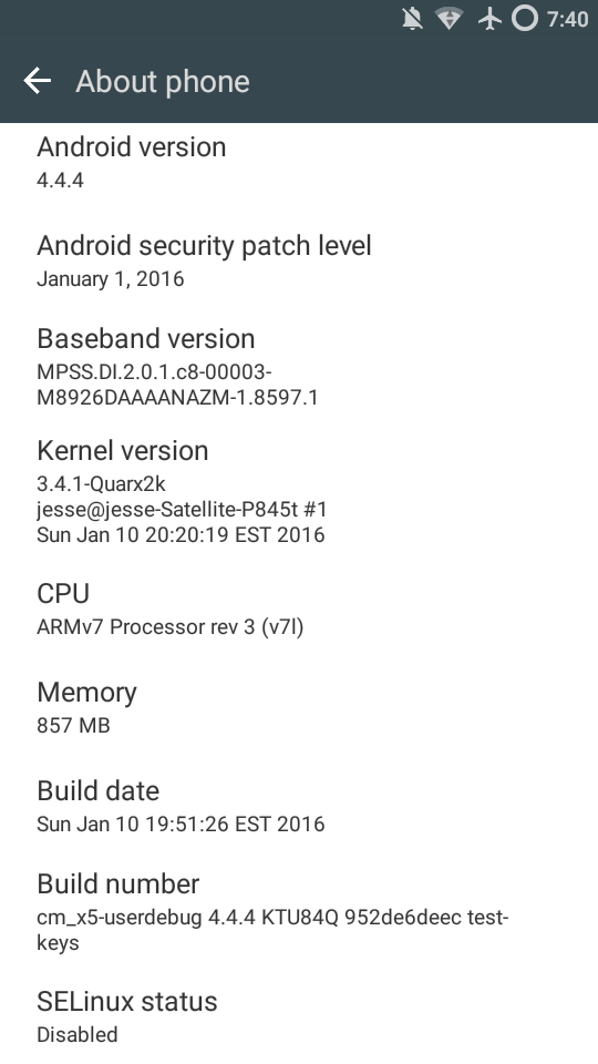

What arm bit is lg volt ls740?
Hope this helps you :)
(Keep in mind that I'm using cm11 but I'm pretty sure that the ARM version is the same on all the Roms)
