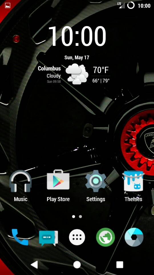

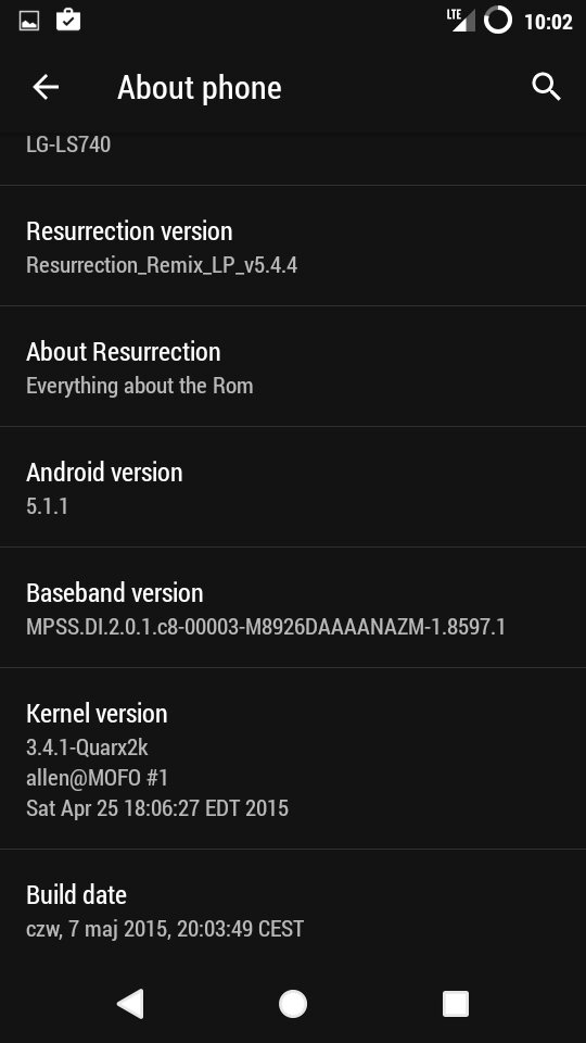

After reading this thread I decided to try Ubuntu..
Installed fine on an older dell laptop I had laying around, and surprisingly works very well!
So I tried following some guides online to try and build cm12.1, man I'm just lost and too impatient!
Decided to try and port... Failure after failure lol!
Finally got something to work!
I think I've ported the resurrection ROM from the L90 using Bad Mofo's cm12.1.
I have signal and data, but says no service
Text and calls work
WiFi works
SD card is not mounting
Home button is broken and flashes constantly
But its working! Lol!

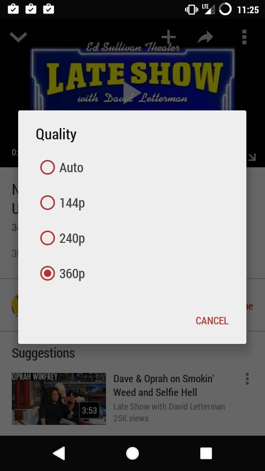

Very nice man. I ran the build for CM12.1 and it ran fine, but I got a boot signature error when I flashed it.
Youtube Video only goes to 360, but HD videos are playing from browser
