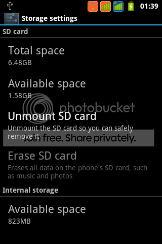

1) On Stock rom
2) On BlueTerror 1.0 by aayushdutta
3) On ICS 2.0 by sagarwep

/dev/block/mtdblock14 /data yaffs2 rw,nosuid,nodev,relatime 0 0
/dev/block/mtdblock13 /cache yaffs2 rw,nosuid,nodev,relatime 0 0
/dev/block/mtdblock11 /gionee yaffs2 rw,nosuid,nodev,relatime 0 0
/dev/block/mtdblock7 /system/secro yaffs2 ro,relatime 0 0
/dev/block/vold/179:2 /data/sdext2 ext2 rw,relatime,errors=continue 0 0
/dev/block/vold/179:1 /mnt/sdcard vfat rw,dirsync,nosuid,nodev,noexec,relatime,u
id=1000,gid=1015,fmask=0702,dmask=0702,allow_utime=0020,codepage=cp437,iocharset
=iso8859-1,shortname=mixed,utf8,errors=remount-ro 0 0
/dev/block/vold/179:1 /mnt/secure/asec vfat rw,dirsync,nosuid,nodev,noexec,relat
ime,uid=1000,gid=1015,fmask=0702,dmask=0702,allow_utime=0020,codepage=cp437,ioch
arset=iso8859-1,shortname=mixed,utf8,errors=remount-ro 0 0
tmpfs /mnt/sdcard/.android_secure tmpfs ro,relatime,size=0k,mode=000 0 0
/dev/block/dm-0 /mnt/asec/com.wmbcaandroid-1 vfat ro,dirsync,nosuid,nodev,relati
me,uid=1000,fmask=0222,dmask=0222,codepage=cp437,iocharset=iso8859-1,shortname=m

@satecsh
@saivignesh
Guys, please elaborate little more..which part didn't work, the mountscript or data2ext part??N please u guys provide me output of "cat /proc/mtd" of ur roms on which u want to use data2ext.
N just make sure u have a boot.img that supports init.d scripts.
To make sure, download tweakz script attached in this post, remove its .txt extension n put it in /etc/init.d of ur device with Root Explorer n give all permission.Reboot the device n go to /data n see if there is a file created name JustBeatIt...if yes the ur boot.img is ok.
Or if u r using zipalign script then see in /data if zipalign.log is created.
done the same but found no JustBeatIt file:( what next??
To all guys who dont see JustBeatIt file in /data
I think ur boot.img does not have init.d support or 2nd thing can be u guys have not installed Busybox on ur device...
Use varun' boot.img or my boot.img from Method to Root Mmx A75 sticky thread in All-Things-Root section, I m using mine img,it also initializes ext2 module on boot, i hv busybox latest n 2nd partition of approx 1gb.
All guys who r not on stock, please don't just flash either varun's or mine boot.img because ICS by sagarwep n SilverLight are port n not modified stock so their respective developer may have changed bootclasspath in boot.img, so wrong bootpathclass will lead to softbrick or bootloop.
So get me ur respective rom's boot.img, I will check whether it has init.d support n will make necessary changes for data2ext n provide in OP.
N when u provide me outputs of cat commands please mention ur rom before it.
@kujang
Ur device has ext2 support n also mounted 2nd partition..1st check the above pre-requisites I hv mentioned, if any of them is lacking then u will not get working data2ext.n mention ur rom.I will check the script n let u know if smthin has 2 bb change,can't do it now,m on mobile.
Thanks.
