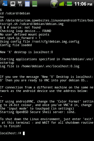

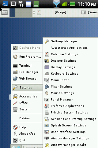

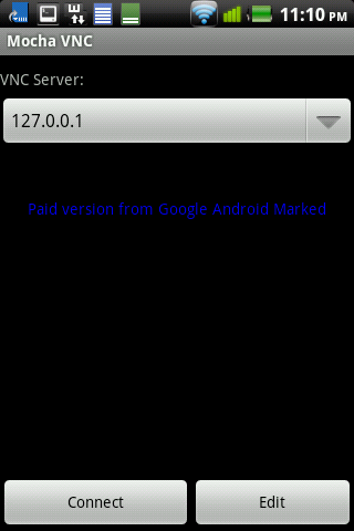

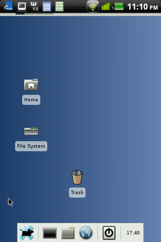

Here is some screenshot..

still needed some changes in bootscript.sh cause it work fine like PC but cant able to mount getting error in etc/fstab after setting in Linux configuration. there is some thing missing in fstab script. becoz of that we cant gain root permissions...even net browser Mozilla Firefox showing (failed to execute default web browser input/output error)
i will keep on updating here if i found any command lines for debian or ubuntu you can PM me usefull cmd lines will update here..
EDITED: internet, video, inbuilt terminal including all softwares working perfectly. not working adobeflashplayer for youtube so no more updates for cmd lines read first post and you get all usefull command lines type on debian terminal...:)
