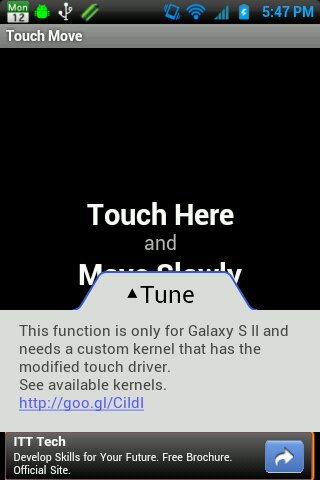

Has anyone looked at this app yet? it doesnt work for the ultra because i already tried but the samsung galaxy s 2 have the same problem with the screen just like the ultra. Now this app was create to fix it by setting the dial to 0 pressing apply and then press enable server. If you hit the menu button while your in the app it brings up to me whats like an entire list of stuff thats has to do with the screen and you can change any of them. It says it requires root of course but still doesnt nothing. Anyway the list of stuff that has to do with the screen, it could be one of them malfunctioning or not. On the samsung galaxy s 2 the file that was change to correct the screen problem was the HYST file. It could be possible that its the same file thats messing up the screen on the ultra.
Lol lets face it, we now know for a fact that samsung isnt pushing out an update to fix our "prepaid" "boost mobile" phone if their not even gonna fix a high end smart phone on a good carrier. Its ashame that developers had to fix it themselves smh.
Edit
theres another way to fix it too by editing the kernel
Kernels that were used to fix the issue
