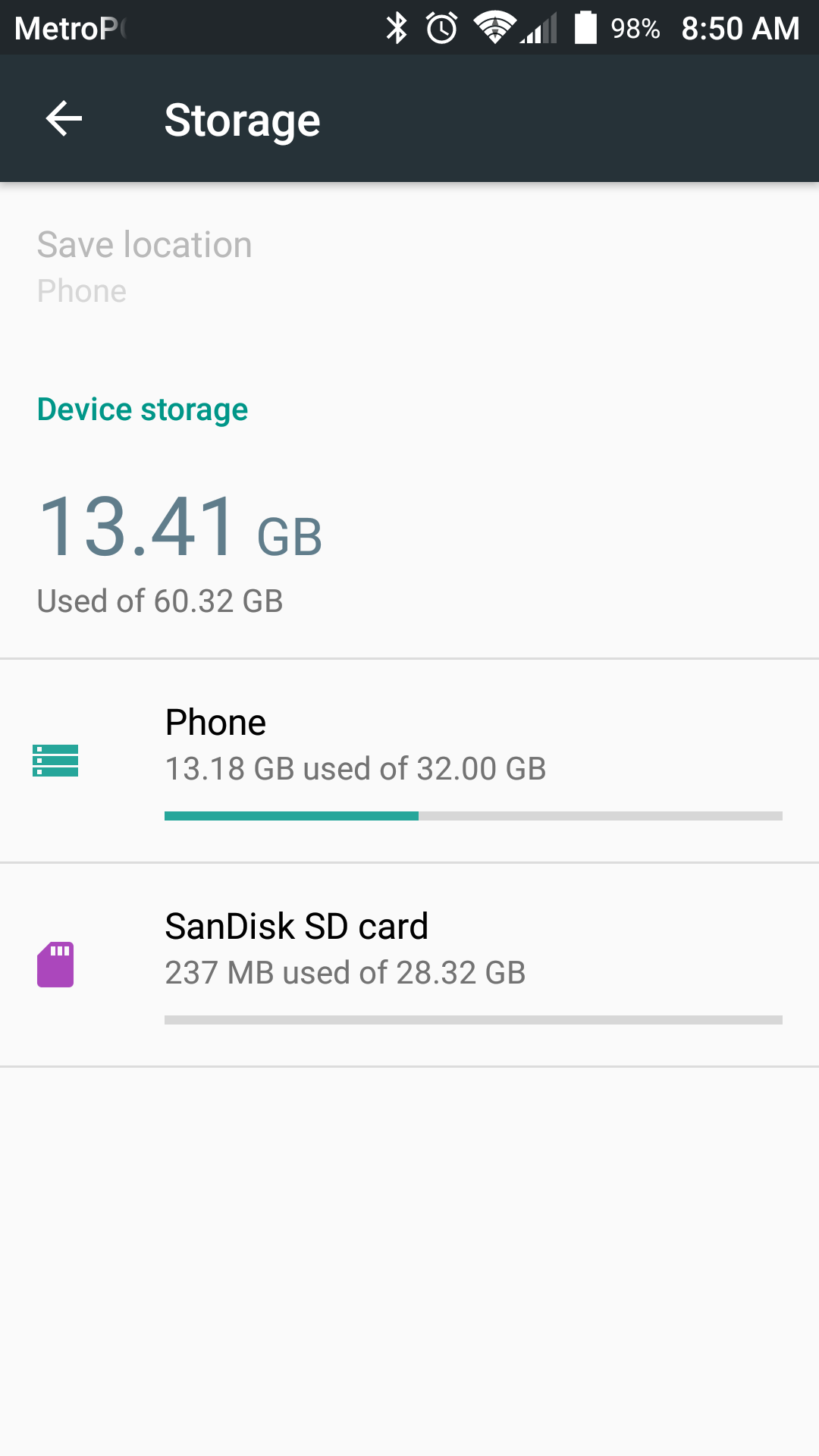

Hello,
I"m trying to change the default save location for the camera. I click on the settings in the camera app, and it bring up the storage options, I have a 16gb card installed, formatted as storage, but the option for "save location" is grey out. Please help?

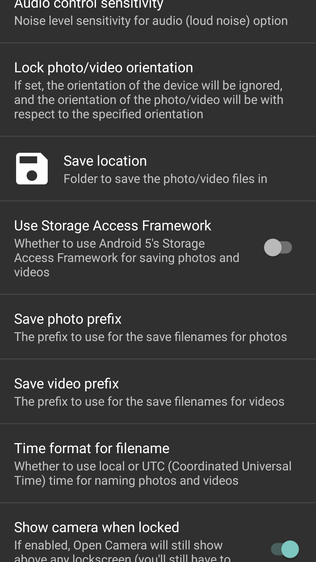

Can you please make a test?
Download the Open Camera app from the Google Store and try to set the default storage location on the SD card to see whether it's a hardware related issue.

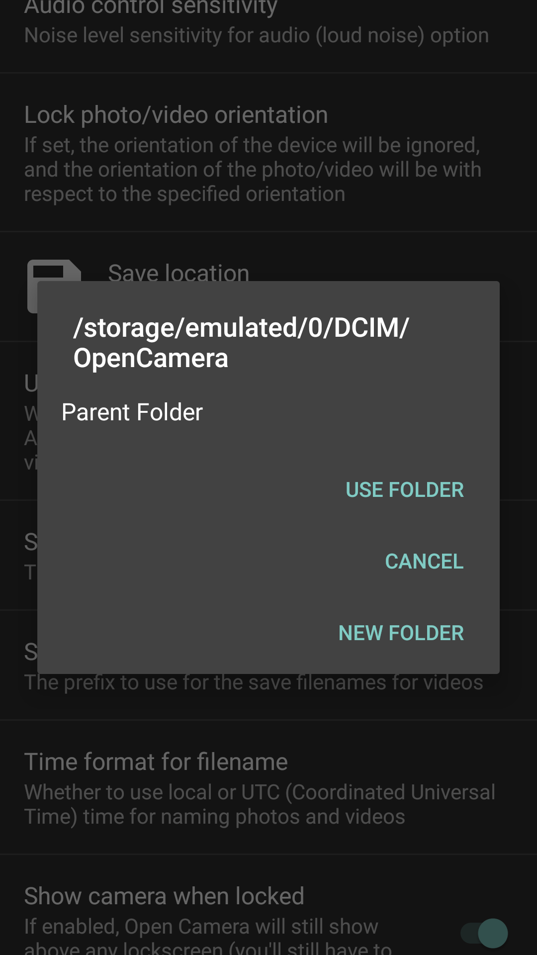

Hi LVT
I downloaded the Open Camera App. Under save location, it just give me an option of saving to a parent folder or to chose a new folder. I don't see any option for SD CARD

Hi LVT
Did you open the left menu to see if you can access the SD card?
If the SD card is accessible, you can select a folder or create a new one for the app.
I did format the card as internal storage, I just reformatted the card again. I can transfer programs to the card. This is what I see in Open Camera. I did not see the screen you posted above.

If you have reformatted your SD card as portable storage, your stock camera app should be able to store photos on the SD card.
If you want to continue using Open Camera, you can click New Folder and type the path to the folder where you want it to save the photos.

Yes if you want to have separate storages you should format your SD card as portable storage. If you format it as adoptive storage it will be virtually merged with the internal memory so you don't have an external storage anymore, that's why the option for the SD card is grayed out.
