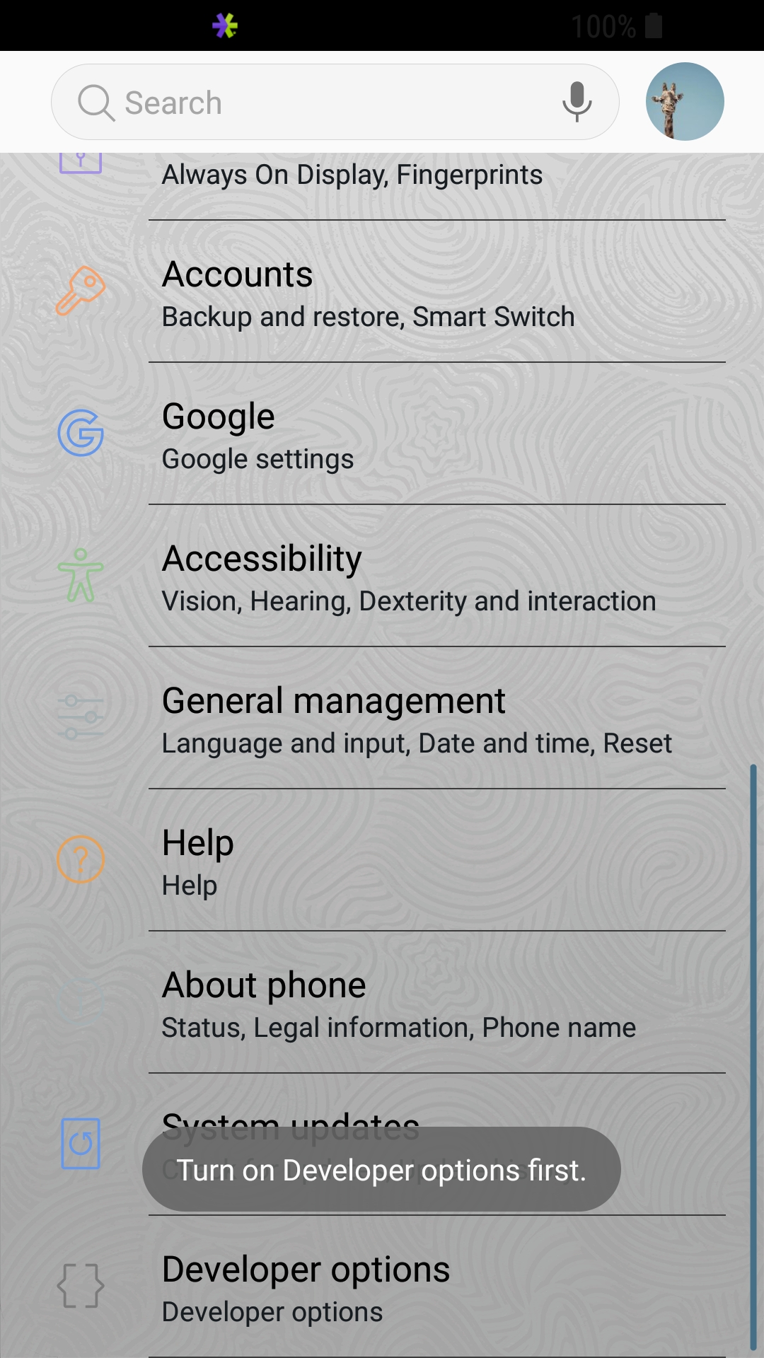

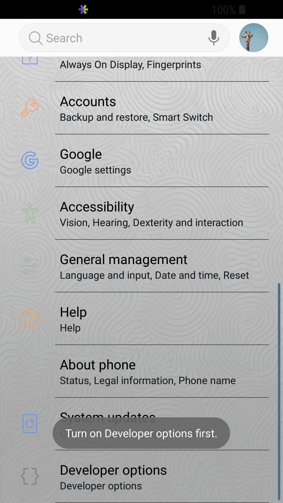

I may be the only person with this problem since I can't find anything in searching around the interwebz....
when i tap "Developer Options" it responds, 'Turn on Developer Options first'
When i tap on "Build Number" it responds, 'Developer mode has already been turned on'
What am I missing, that not a single guide I have reviewed has mentioned?

If you read the 2nd line of my OP, that's what it does, and that's all it does. i don't know of any other location in the phone the developer options exist.

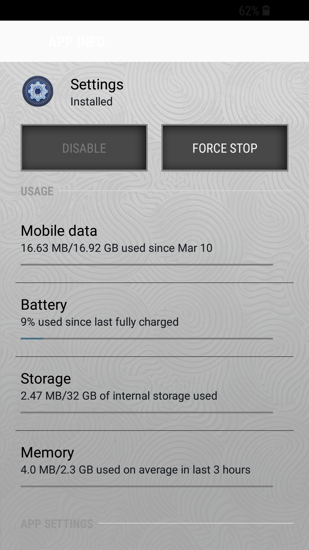

Going into the Settings App, there is no option to clear data.

Are all your other apps like this too? It seems strange there's no 'Clear data' option, it will be really odd if the same problem exists for all the apps on your S7.

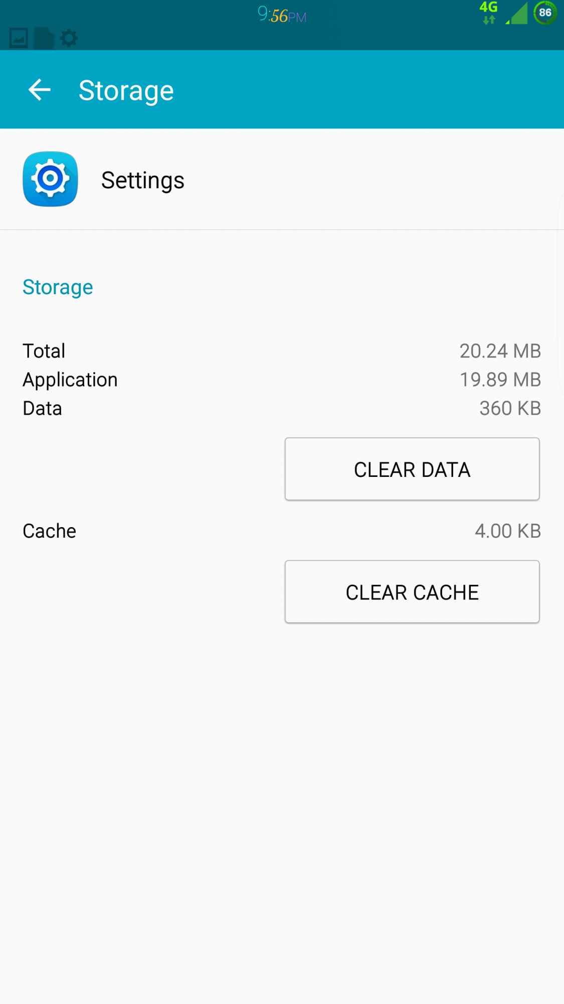

AHHHHHHH, I found it. On mine it's:
Settings cog > apps > settings > storage > (options for 'clear data' and 'clear cache')
Question then becomes, what will 'clear data' actually get rid of, anything of importance?
It's the Settings app itself, there are no user options menu to alter it's appearance or functionality. Look through the entire Settings >> Apps >> Settings menu to note what's there.
Use Clear data on the Settings app, and then see if you can enable Developer options normally again.
That cleared it! Thanks to everyone helping out. Man, what a pain that was. That 'clear data' button seems to be a different location on my phone than others it seems.
