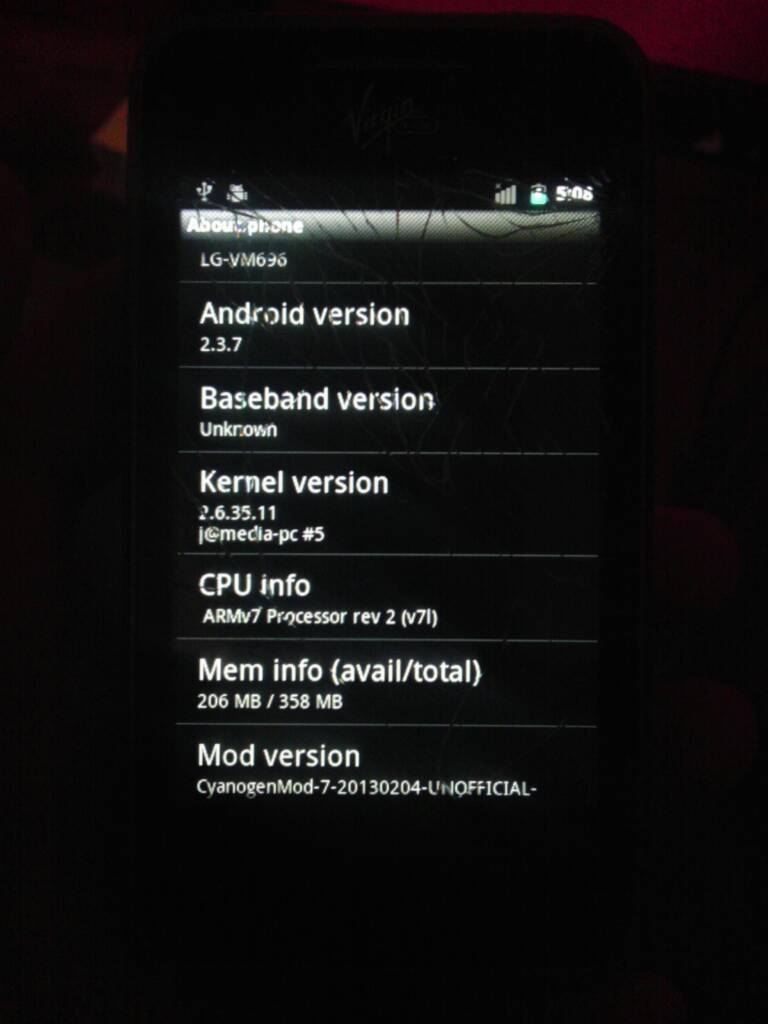

CM7 using giantpunes source. Nothing works, ill be starting with cm7 then on to cm9, etc. That statement can change at any time lol
I hate to have to tell you this, but it looks like your new phone may have a minor imperfection on the screen.
