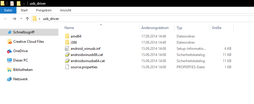

Sometimes there is an issue with Windows installing the fastboot drivers.
Download this driver on your PC and extract it:
https://developer.android.com/studio/run/win-usb.html
When you're in the bootloader and connected to the PC, open the device manager on your PC and look for a device with a yellow triangle.
Try manually selecting the driver by choosing"have disk" and browse to the location if the driver on your PC.
If you still can't get it working by doing that, perhaps the cable you are using is a charge only cable and incapable of transferring data?
I can see the device with the triangle in my device manager, and also tried to install new drivers.
And downloading the USB Driver didn't change anything aswell (or I just "used" it wrong)
And I also made sure to use various cables and some which I already used to transfer files.
