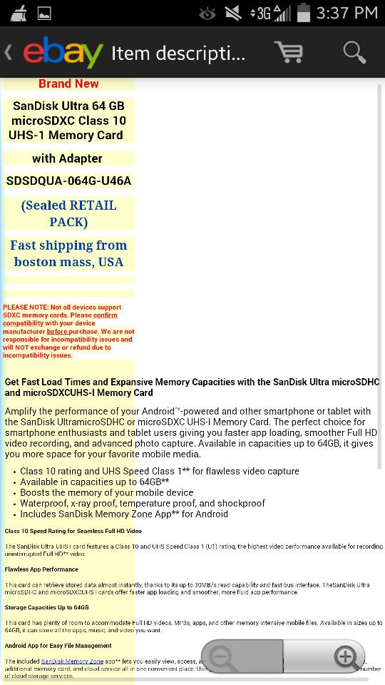

Does a 64GB micro SDHC card even exist?(Not SDXC) I was under the impression they only go up to 32GB SDHC and then 64GB SDXC. The seller is giving me a refund, I'm just sharing my experience. The card is extremely slow loading mp3s and when they are there they are unplayable. My note 3 says it's corrupt and needs to be formatted. I cant believe this seller on eBay can just sell junk like this and get away with it.

I used MiniTool Partition Wizard Home Edition to format to FAT32. It comes back as a bad disk. I still have it in hand and SD Insight shows its a 67 GB, model APPSD, manufacturer is INVALID. This thing is a hunk of junk.
That 67GB is what the controller has been programmed to return as the card size. h2testw should read the actual memory card and tell you how large it is - which is probably pretty small. It's a counterfeit no matter how you look at it, though.
