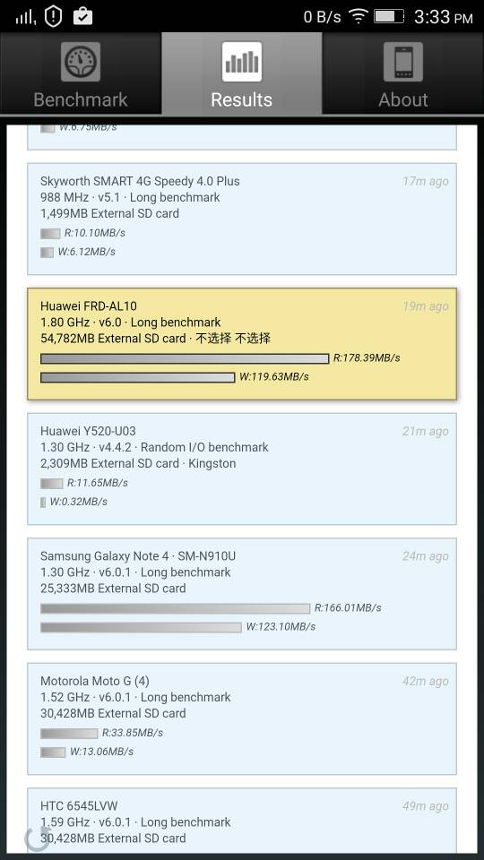

I know of no such list. But I know there are ways to test. I remember a thread here asking for info, and someone used a tool to measure write speed of his Android to card and got rated at 20 MBps, hence it supported at least UHS1 since C10 is only 10MBps.I believe that the UHS is backward compatible with SDHC, but which devices or Android versions can really take advantage of it? Of course it's optimized for any device that supports it.
Yeah. Max speed for UHS1 is 312mbps if I remember correctly.View attachment 114270
I made a search with A1 SD Bench database and found a Huawei with impressive read/write speed.
