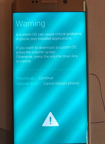

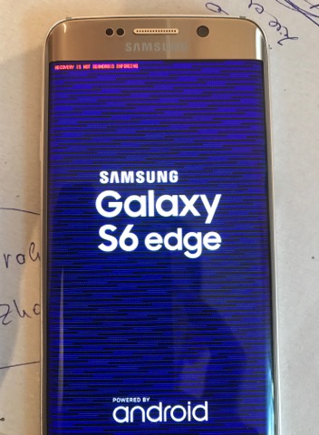

Hello i have a problem with my Samsung Galaxy S6 Edge. My phone doesn't open, i press the power button and it just Samung... in a blue with black screen. After this i try it with Power + Home + Volume down button and switches me to a page WARNING A custon OS can cause problems..... and press Volume Up: Continue or Volume Down: Cancel (restat phone). I try it volume down fist and nothing, i try volume up and switches me to an another page Downloadin (Do not turn off target) but again nothing.
Plese help me, have any way to recover the photos?

I'm not a Samsung expert but that sounds like it's booting into download mode. So the question is why?
Are all of the keys working normally? If some key combination during boot is used to get into modes like this then a stuck key can produce this result. In which case you might be able to unstick it.
Otherwise can you post clearer photos of the text. I think the first screen says that recovery is not detected, which is worrying, but I can't read the rest (too blurry). And have you ever tried to modify the system software (unlock, root, install custom recovery, etc)? Has the phone had a previous owner? Has it ever got wet? What happened before this started (anything, even stuff like running the battery flat)?

At the first photo with red text say: “Recovery is not seandroid enforcing.”
At secondary photo say:
“Odin mode
Product name: SM-G925I
Current binary: Custom
System status: Official
Reactivation lock: Off
Secure Download: Enable
Knox warranty void: 1 (0x0304)
RP SWREV: B:3 K:2 S:2

The Current Binary, and Knox Warranty statuses does look like either an attempt has been made to root and modify, or there's possibly a fault with the phone. Those should state "Official" and "0" if all was well.
Could be worth trying to re-flash the firmware with the appropriate ROM from Sammobile.com

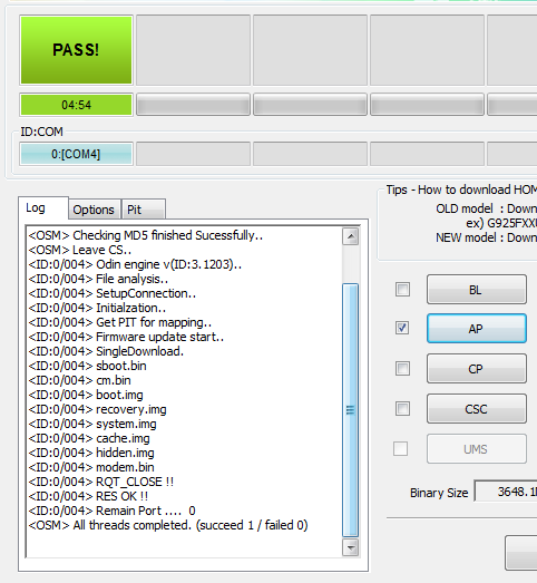

hello i flash a stock firmware according to the instructions but again the screen stuck on Samsung welcome page, o_O any idea???
When you were doing the flashing process it should show you a green 'PASS' message when done, if you saw any kind of 'Failed' message what did it state?
OK, at least that's a good sign. Try rebooting your phone into its Recovery mode and select the 'wipe cache partition' option.
Recovery is a text-only interface so you need to use the indicated keys to navigate through the various menu options. Be careful not to accidentally select something by mistake. Anyway, try wiping the cache partition and see if that will allow your phone to boot up normally.
And this is very much a long shot but try booting up with the SIM card removed. Not likely but others have stated this might make a difference.

I tried reboot my phone in recovery mode, but don’t open in recover mode...any idea??
Try re-downloading the ROM (in case the prior file was corrupted in any way during the download process and double-check you've selected the proper one) and go through the flashing process again. Also, flashing the stock Samsung ROM also installs a new Recovery so something either didn't 'take' or there's some other problem. Just want to emphasize checking you've chosen the appropriate ROM, not booting up properly and not even being able to boot up into Recovery mode indicate either a problem with the ROM or its not the correct one.
So just to confirm, no error messages while re-flashing with Odin?
Also, your phone still won't even boot up into Recovery Mode after that?

HI. Sorry to invoke this old thread. I have a S6 Edge with the exact same issue. . Just wanted to know if you found a solution.
I download the correct firmware and pit file.. Odin shows pass. but phone doesnt boot otherwise. Only into Download mode. I suspect the knox warranty has somethin to do with this ?
why do you suspect knox? is the phone rooted? can you post a screenshot of the odin's complete output?
